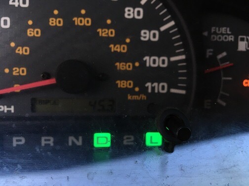

I’m having a hard time figuring this one out. Here are the symptoms: The gear indicator lights in the cluster for D and L are lighting up at the same time. The transmission feels like it’s in L when in D. The 10a fuse for the gauges blow shortly after this issue presents itself. After the fuse blows, the transmission feels normal in D.
So far I have done a few things to troubleshoot. I found and insulated a slightly exposed green wire under the dash that was tapped for a trailer brake harness. I removed the neutral safety switch, cleaned the contacts, adjusted and installed. I replaced the blue shifter bushings. I replaced the cluster. I replaced an Abs sensor on the front driver side. Installed a scan gauge 2 to check for Stored codes.
After I did all of the above, The issue went away for about a week. I hit a bump this morning and the transmission felt like it shifted into L. At the same time the indicator light for L came on faintly with the D still lit up. I shifted into 2 and drove towards home. I hit another bump and the 10a fuse for the gauges blew. After I lost my gauges, I was able to shift into D and drive home.

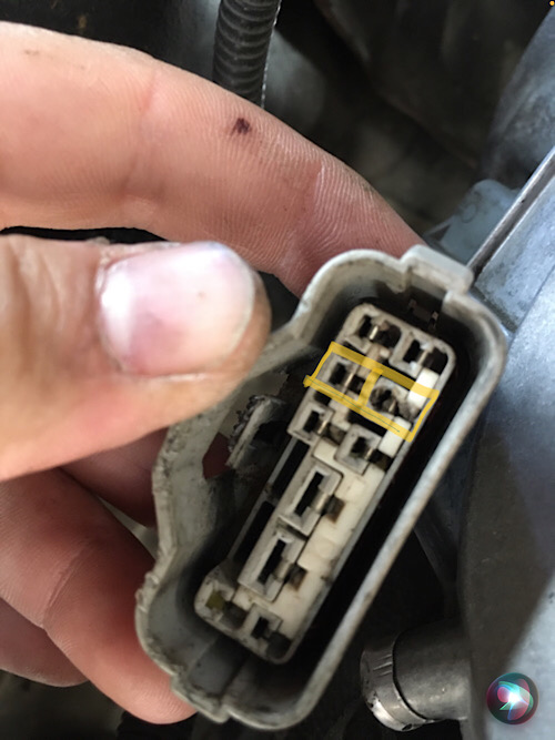

Pictures of dash and NSS connector.

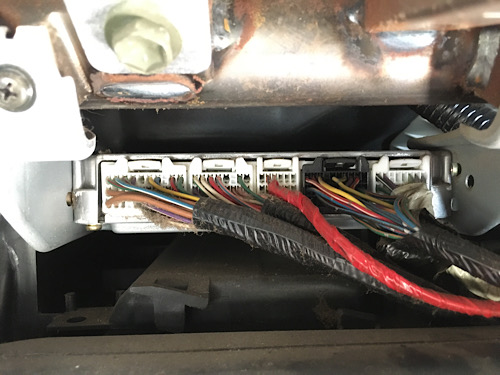

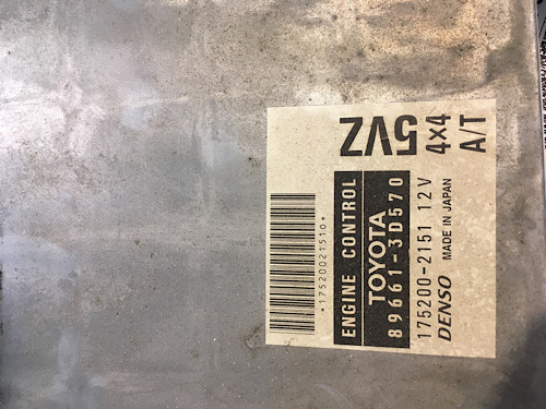

I removed the ECU from behind the glove box and nothing stands out on the circuit board.

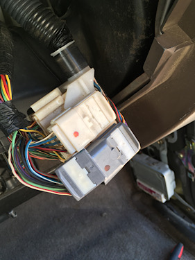

Thank you so much! I located the harness/connector from the NSS behind the glove box. Unplugging this connector turns the indicator lights off on the dash. Hopefully the issue is easier to isolate now.
yes I would think you could check for continuity in the 2 wires upstream and down stream of that connector? I think. this way it tells if it's engine side wire harness or body harness. either way it's not going to be fun to track that down.
post back I would love to know what is happening here?

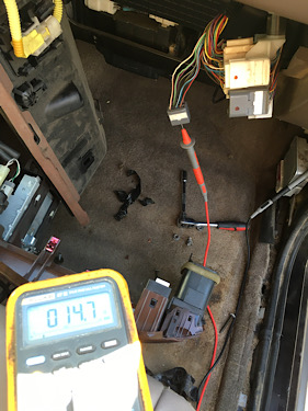

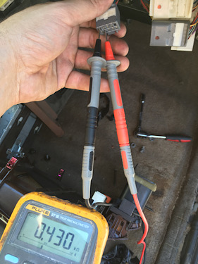

I connected a multimeter to each end of the connector behind the glove box and tested continuity between light green and white/red. I also tested light green to ground and white/red to ground. This should tell me if the wires are making contact with each other somewhere right? It’s been awhile since I’ve used a multimeter for more than voltage. If I should be testing a different way please let me know.
Battery is disconnected, NSS is disconnected.
Glove box connector:
Light green to white/red -.4 k ohms
Light green to ground - 5 k ohms
White/red to ground - 14 ohms
Under truck at NSS connector:
White/red to light green - .4K ohms

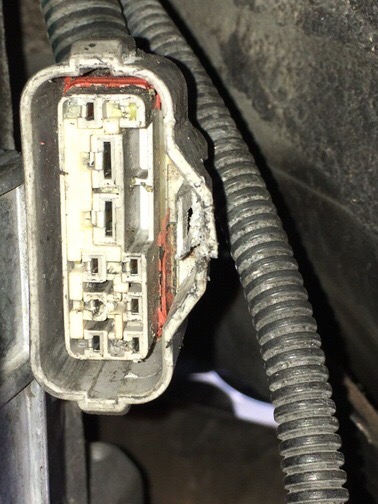

From what I can see under the truck the light green and white/red wires are across from each other in the connector. I drew squares around the ones I’m referring to. Can anyone confirm this?
The white/red hole looks like it’s melted at some point. I’m wondering if the short is in the connector.

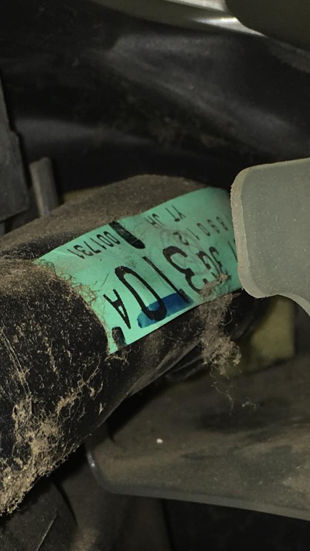

I found the sticker on the harness and snapped a picture.
Part # is 821213G310A
I'm searching for a replacement now.

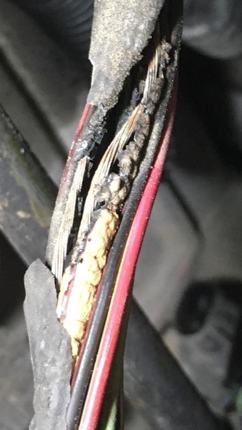

I started unplugging the harness from the trans and O2 sensors so I could fish it out and get a better look. I found a few exposed wires near the neutral safety switch connector after peeling back the plastic.
