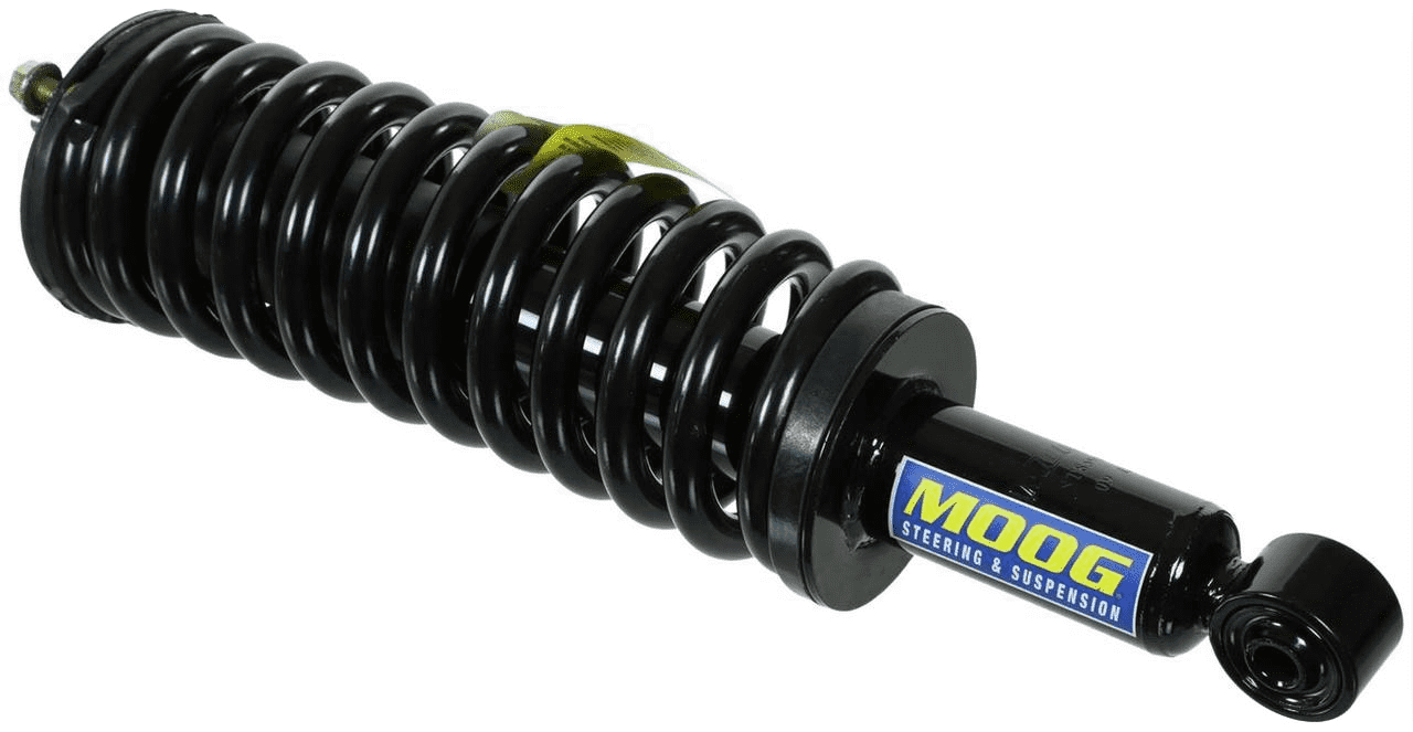

Ok so I recently purchased a 1999 limited that I was told had a 3 inch lift. Either way I figured it was a spacer kit. No big deal. I'll swap some coils in later. So here's my issue. He had receipts showing that the coils were replaced in March with Moog ST8595L then had a toytec 3" spacer on those. Also added 285's on the stock 16" rim's. The rear measures about 23 inches from the hub to the fender flare. Here's the kicker though, the front still looks stock even with the spacers. It measures 20" from hub to fender. I'm at a loss at why the front isn't lift more. Any help would be appreciated

Oh and to answer your question it looks like the cheap Moog springs absorbed all the space the spacer added judging by how they are compressed

Lol, that's a TON of spring pre-load on those front coil-overs. :crazy:

yikes, those springs are so compressed, cant imagine what they feel like when you hit a bump, even a speed bump
well I guess I can imagine, no springs no give
If that's the kind of work the PO did, I wonder what else you will come across.
4runners are like sailboats, which I have also done. The previous owner is just as important as the thing you are buying, maybe more so.
That is the most obscene resting spring I've ever seen. Clearly they grabbed whatever spring laying around that had the right diameter and shoved it in there.
Well, unfortunately that is what the Moog coilover is judging by the picture of the coilover.
That is a lot of coils in that spring. But it is worse for the OP because the PO has added the Toytec preload spacer between the top hat and spring, thereby squishing the spring even more.
As well as the spacer above the top hat. Craziest thing ever.
So yes these are coming off tomorrow. What's crazy is it's not a terrible ride. However I've not really been offroad since I bought it so in the road it's not bad. The moogs will be going in the trash!
