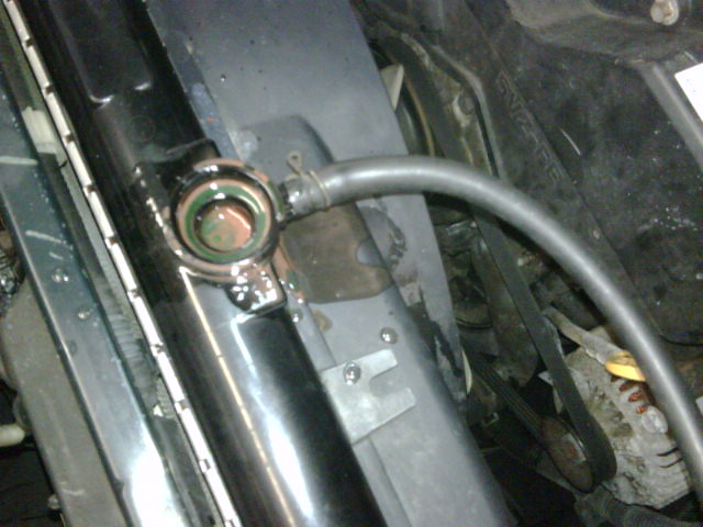

As to the tranny, I discussed with the shop manager the transmission and pink milkshake. He said that the fluid looked fine to him. ( got a new radiator anyway, so that is suspect ) 1st gear would hardly move the truck. Once 2nd gear took over, all other gears worked fine. It was replaced with an LKQ used unit with about 85K miles on it.

The temp started climbing while sitting idle with the air on for about 30 minutes Friday night. Put in a new thermostat over the weekend. Since the truck had been sitting for a while before I bought it, I went ahead and moved the levers for the heat at the dash and the rear heater. Guess what? Diluted pink milkshake! Now that I have opened those valves and circulated that crappy fluid, I need to do a rad. power flush to get it all cleaned out.
At 112K miles, I knew the tranny shouldn't have gone kaput.
I just wanted to confirm the initial diagnosis with you guys :)

Well at least you know the transmission died from the milkshake and not being abused. I would go ahead and do the transmission cooler bypass if you are planning to keep the truck for awhile. I replaced my radiator as a preemptive and still bypassed.
Yup, that is the plan. Gotta find the paperwork for the last one I ordered. It wasn't that long ago. I did all the research then and got the best price. Don't want to do it all over again :)
