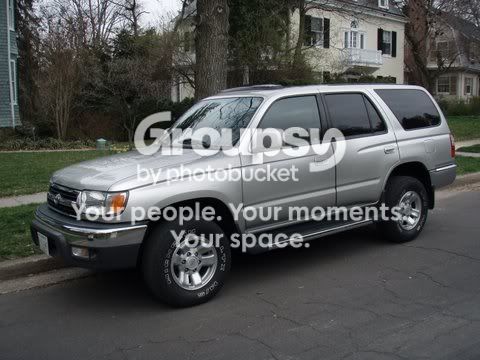

Hey guys. So I'm a newbie not only to this forum but also to my 4runner. I bought a used '99 SR5 2WD with 75K on it last March. I've got a couple questions I figured you guys could help me out with. It's completely stock but I want some advice on some good mods to start out with.
I'm unhappy with the stance of my car, it's sitting on 15" tires and I feel like it just sits too low and doesn't look like a 4runner should. I want to get some bigger tires, either 16 or 17" but I'm not sure what kind are a good option. Since I have 15" tires on there now, am I going to need bigger size rims?

P3301046.jpg~original
EDIT: My tires are 225/75 R15 if that helps.

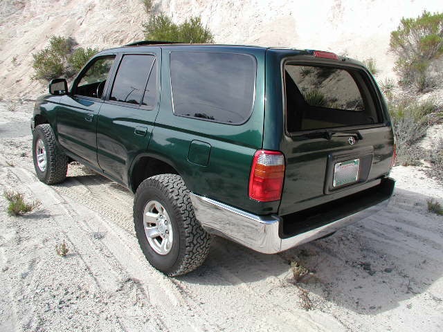

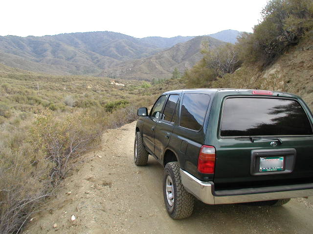

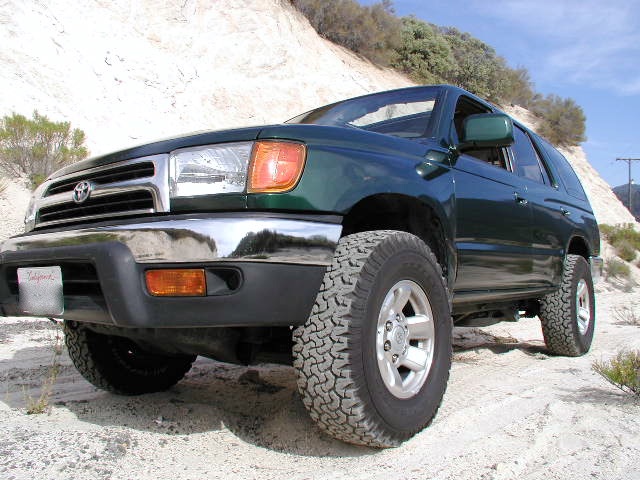

Here's a picture of my 4runner with the 31" BF Goodrich tires, and running boards removed. Let us know if you have any more Q's.

Lookin' good, Dude. So the bigger tires gave you a noticeable difference of about 1-2"s? It just feels like my car is a wimp with the small tires and I want to give it a more aggressive and solid look, and I would like to start with new tires before even considering any lift.

Yeah the tires make a huge difference. The 3rd gen 4runners actually came with different sized springs depending on the year. Most of the 99's came with 1-2" taller springs than the other years, and by the looks of your rig in the picture, I think you've got the taller springs too. So the taller springs, combined with a 31" tire will give your truck a nice tough, solid look.
