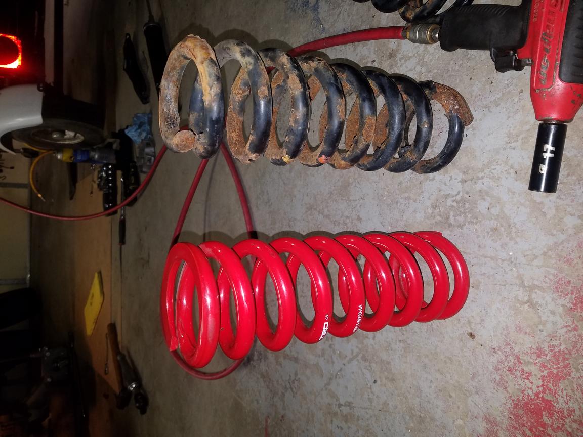

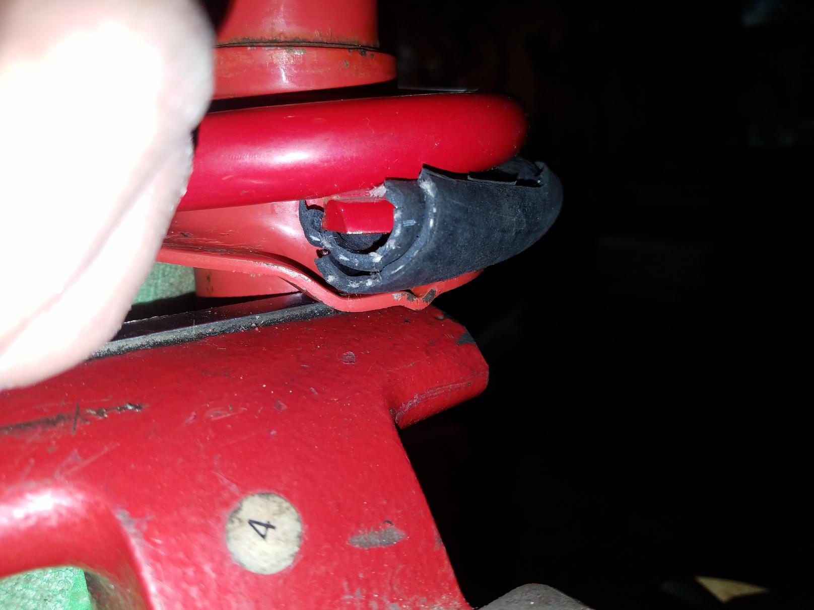

I got them from a member on here stating they would work for a 3rd gen yet when they arrived realized they weren't pig tailed on one end but they were square on top and bottom..i rigged up some rubber hosing to fill the void at the bottom and they've stayed center ever since..but I've always been after the '99 coils due to the fact I like the lift it adds also seems as if when it has a payload the moog are a little soft but their still a great replacement stock spring.

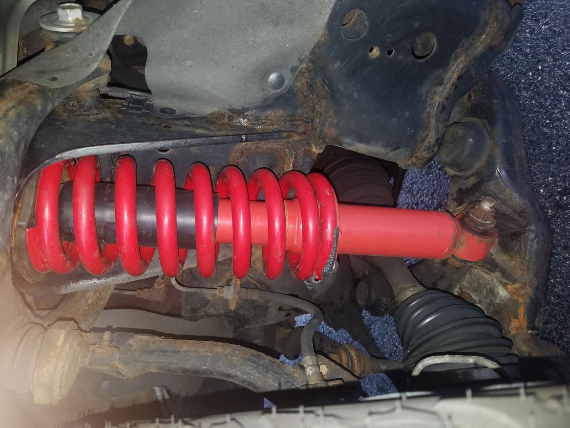

Here's how I got them to work! So far they've been staying completely center.

The red TRD springs look good. I'm guessing they ride well.

Yeah I ended up pulling the front springs off the '99 as well and swapped them out over the weekend..man it looks great!! They were still pretty stout and in good shape...looks like I'll have some Red TRD coils for sale here soon! They were a nice spring just wasn't to comfortable on the way i had them setup..
