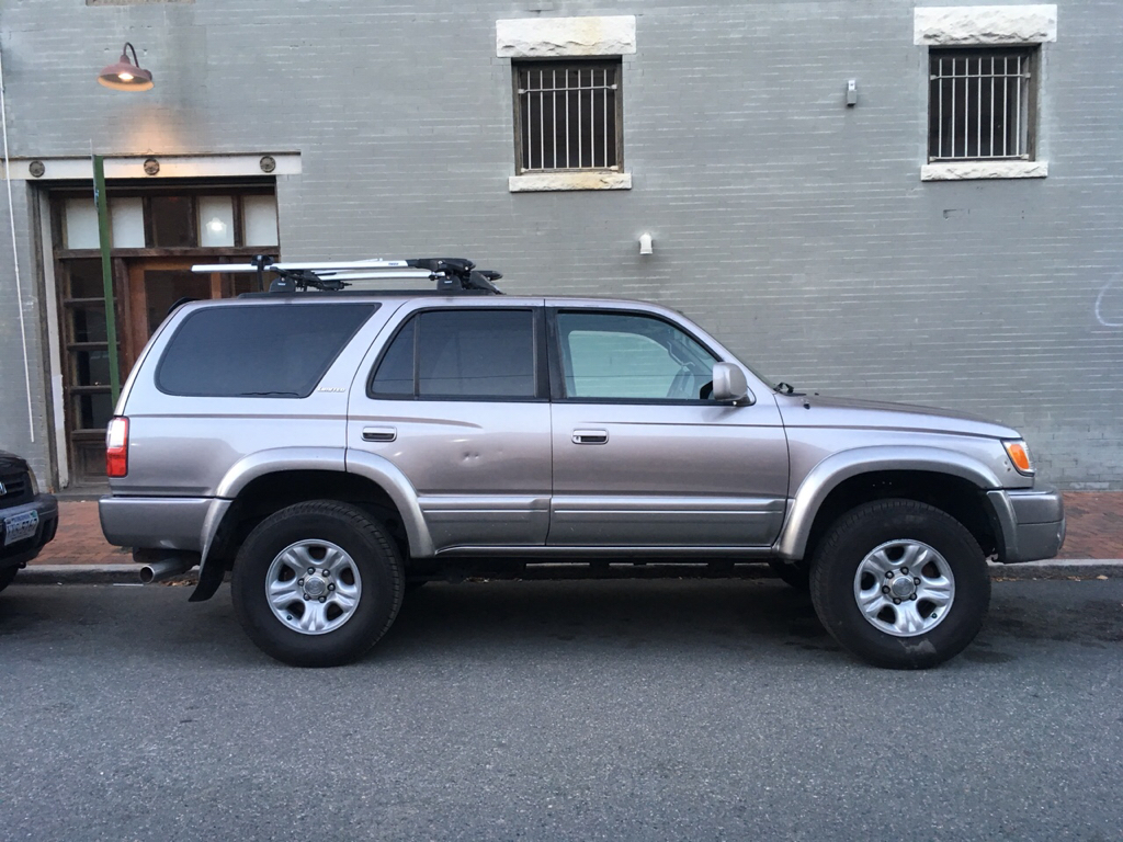

Can’t speak to the different trim levels/color codes but these ‘16 trails sit nicely with 99 talls. [MENTION=116470]Tyler James Inc[/MENTION] used them on his old setup, I believe.
Pictured, I have them on the rear currently but put OME 880’s up front so I’ve got 906’s waiting to lift up the back a bit.
