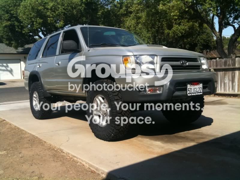

It'll look exactly like this, 99 with 2.5 daystar lift:
b8d56102.jpg~original
do you have any issues with rubbing with the 33s? love the truck..
I don't have any issues in full lock when making u turns or anything like that. The only rubbing I get for some reason is the rear drivers side when I go wheeling. It's not that bad, but I have been contemplating a little body lift. But overall, I have no regrets, it's a nice easy way to lift the t4r.
