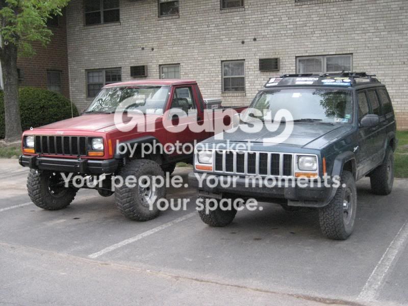

A bit of background- I wasn't much of a wrench guy until a bought an '85 CJ7 back in college, and well, that sort of forced me to become a wrench guy. It would have been parked more than driven if I didn't fix it. My roommate had one as well, so we learned together. My cell phone voicemail message used to say, "Either I'm under my Jeep fixing something and can't reach my phone, or I'm driving it and can't hear my phone ring, so leave me a message and I'll call you when I get off the concrete." Well, I went through that Jeep, did an engine swap, sold it; bought an '98 XJ that was my mildly built DD. Had OME suspension, axle swap, rear disc conversion, intake swap, yada, yada, yada. Bought an '88 MJ for a wheeling truck, did a SOA conversion on that and had it rolling on 33's for awhile, but sold it because we needed the money. Ended up with a '99 TJ on 33's for my wifey, she'd always wanted one, so we bought one before we had kiddos.....so when the kiddos came, out went the TJ and in came the Subaru.
MePullingStuckJeep.jpg~original
IMG_1084.jpg~original
IMG_1484.jpg~original

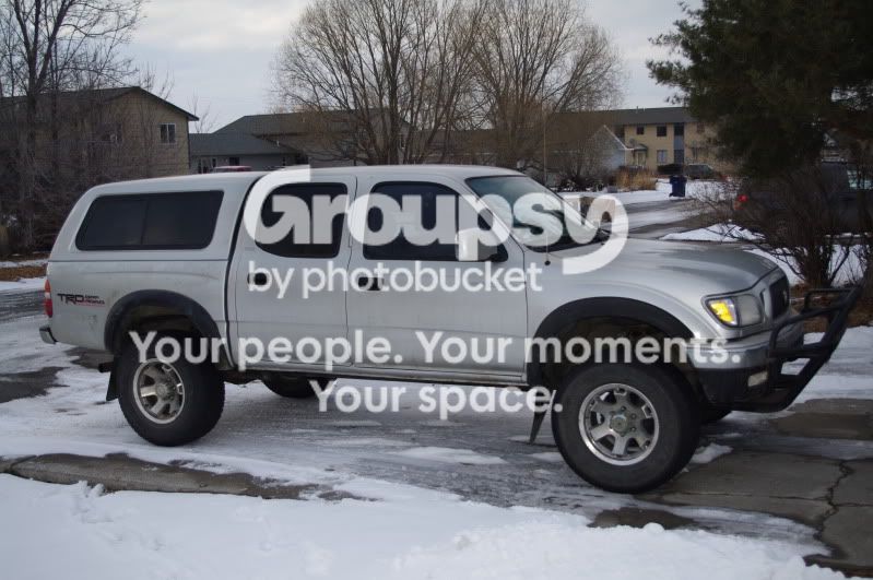

Fast forward a bit, the kids and all our camping crap don't fit into the XJ any longer, so we sold that and started looking at Toyotas. Wound up with an '03 DC Tacoma that we still have, but is primarily the wife's kid hauling rig.
IMGP6994.jpg~original

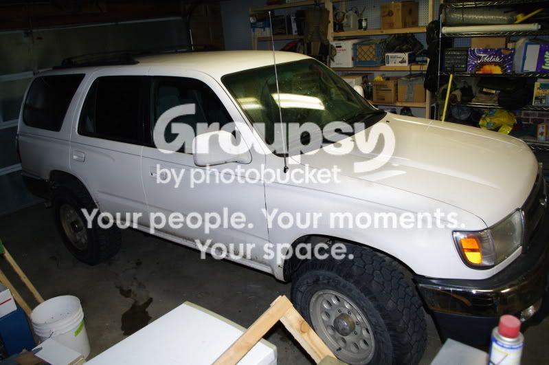

So a few weeks ago, I ran across an ad in the local paper of all places (who reads the paper anymore? :confused: ) It read like this: 1999 4Runner, 215k miles, needs work $3500." So I called and asked her to expound on the "needs work" part. She said it needed brakes, a windshield, tires an alignment, and a few other odds and ends. I did some research, it also needed it's 2nd timing belt project. I asked her if I could stop by and look at it, so I did, and the For Sale sign she had in the window said $2500!? I called her back asked her about it, she said she figured it needed at least $1000 in work, so that was the price difference. I haggled her down a bit more because of the timing belt, and we had a deal! She took the cash and gave it to her bank for a deposit on her 2007 4Runner, and I drove our new 4Runner home for $2200!
IMGP6998.jpg~original

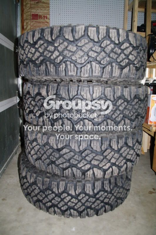

I also picked up these off Craigslist:
IMGP7010.jpg~original
Which was a huge score- not so much on price, but there are sacrifices to living way out here in Montana. Craigslist isn't exactly a cultural phenomenon out here. You're almost as likely to find deals in the paper as on Craigslist. Anyways, I've been looking for tires for my Tacoma for more than six months and haven't found anything I'd buy in a 265/75/16. These came up and I talked to the guy about them- he bought a used Chebby from the dealer, and it had these tires on it. Turns out, the PO of the Chebby put these tires on right before he traded it in, they only have about 1200 miles on them. The catch was that these are the 10 ply, load range E tires. I wasn't sure what to think about the load range E, so I did some digging and reading here, over on Expedition Portal (where I also spend some time) and on a few google searches in FJ and Tacoma forums.
The result of my readings was this- the most opinionated people against E rated tires frequent this forum. I'm not joking either! I'll try to sum up some of what I read, though I'm sure I'll miss a few points. Load range E tires have a higher load rating because they are built to handle hauling and towing heavier loads. I know, it's difficult to understand.....
They aren't constructed the same because they're built to do different things. If you're towing a 4 ton trailer with an F250, you're likely going to want a different tire than you've got on your 4Runner. On the other hand, just because it's on your Ford, doesn't mean you CAN'T run it on your Toy. Full-size trucks run E rated tires in the range of 80 psi, which makes sense- you don't want a squishy tire when you're trying to maintain control of a large trailer. But there's no reason you need to run the same tires at the same pressure on a 4Runner.
I did run across some type of equation to calculate what tire pressure you should be running an E range tire at on a 4Runner, which I can't seem to find at the moment, but it put it in the 40-44psi range from what I remember.
The bottom line is this, and I wrote this in another thread on here- the "ride" of a tire is a VERY subjective thing. It's like asking somebody if something is "loud." You ask your mom and you ask your buddy- you'll have two very different answers. A lot of it depends on what you expect your truck to ride like. If you expect it to be like a Lexus, buy a Lexus. If you expect it to ride better than your old '87 Toy pickup, you'll likely be fine with E rated tires. It also depends a lot on the condition of your suspension- the newer and more tuned your suspension is, the less you'll notice the tire difference, just as you will notice road imperfections less. But if your suspension is shot, then no don't buy E rated tires and expect it to not be rough.

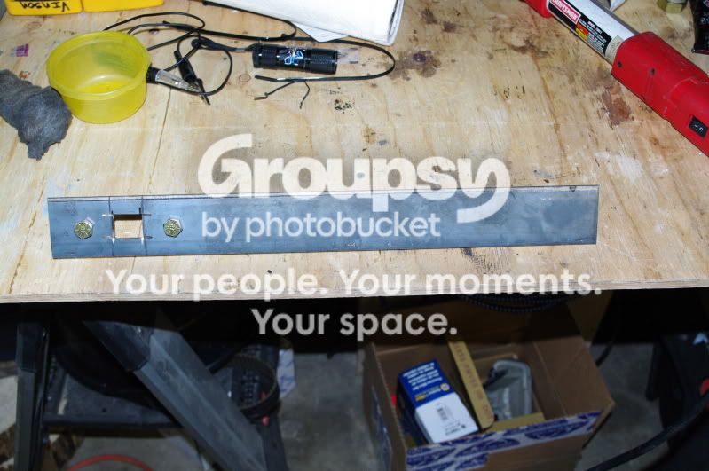

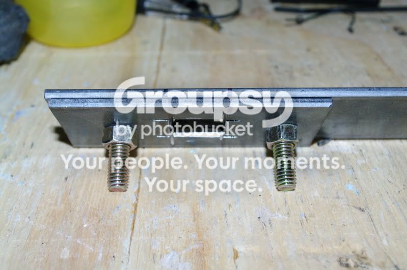

-I only made one "tool"- something to hold the crankshaft in place while I broke the nut loose. I purchased a piece of 3/16" x 2"w x 36"l flat steel and two 3/8" grade 8 bolts and four nuts to hold the crankshaft pulley. I then cut a hole in the center to allow my 1/2" drive socket to pass through the "tool." I allowed the tool to rest against the frame and broke the nut loose with a breaker bar and a pipe. This worked just fine for me, but my truck is not rusty at all.

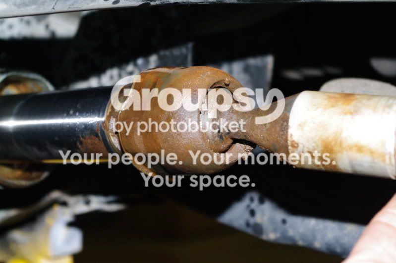

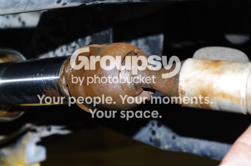

I did replace the inner tie rod ends- they were completely toast. The passenger’s side had about ⅛” play in and out, which translated to almost 1” of play at the wheel. It was a bit scary once I saw how much it moved when I had it up on the jack stands.
IMGP7004.jpg~original
IMGP7003.jpg~original
I bought Moog parts from RockAuto. The inner tie rod ends ran me $41 each, and I had to replace one of the boots, which was $9. I did the whole works without removing the outer tie rod ends, which was nice. I did a rough alignment with a tape measure, so I know it's close, but I know I need an alignment bad. I need to replace the sway bar links and bushings first though.

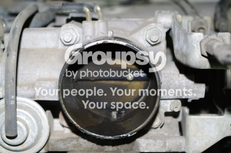

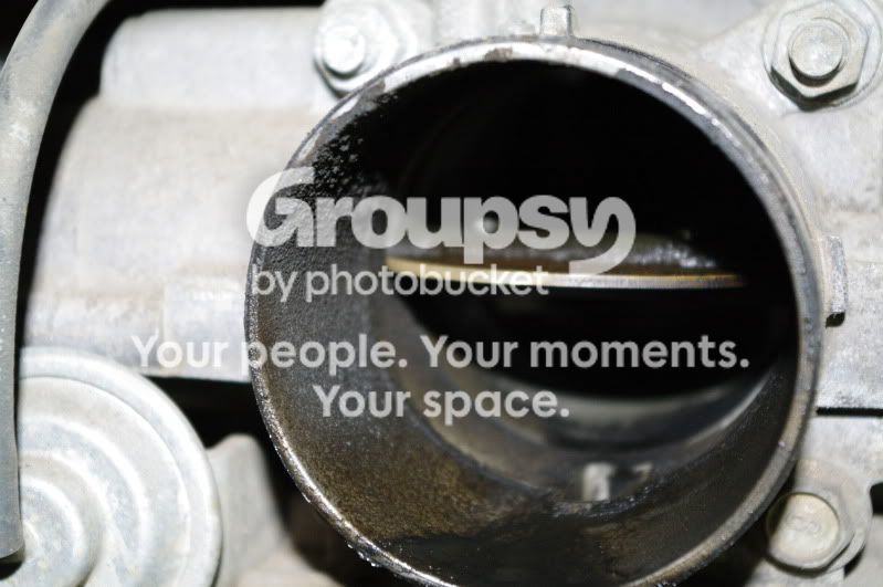

I took the intake apart and cleaned that all up, after I ran seafoam through, probably should have cleaned some crap out first, but oh well. Idle ran high after seafoam, but it worked itself out over about 10-15 minutes of driving. Here’s how the throttle body looked:
IMGP7012.jpg~original
IMGP7013.jpg~original
My idle seems to be a bit high again, between 1100-1200 in neutral. After doing some reading, looks like I need to clean out my IAC (idle air control) valve a little better. It was pretty gunked, and it’s hard to clean. A post I read recommended removing the intake tubing; then, with the engine running, spray some MAF cleaner into the small passage at the base of the throttle body. This will allow the engine to pull the cleaner through, and hopefully some of the gunk with it.

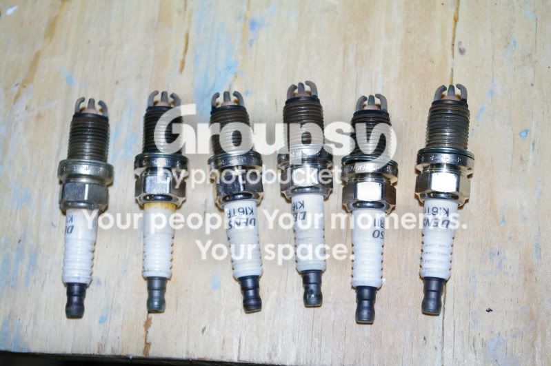

Did my plugs and wires while I had the intake out, plugs don’t look too bad, definitely worn though, which is good news I guess. Feels like it runs a bit smoother, but who knows.

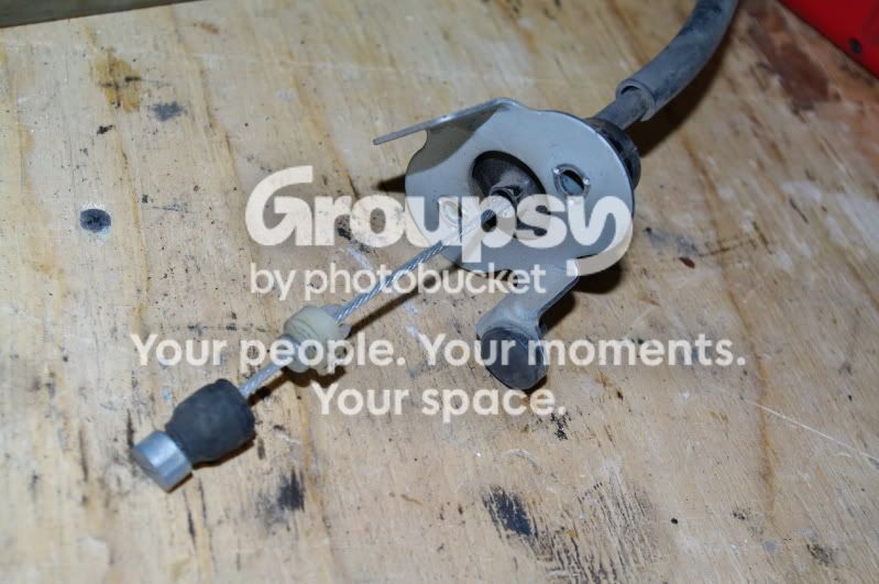

I also replaced my main throttle cable. The difference in the feel of the pedal between my T4R and my Taco was night and day. I was able to source a used one for $20 off of a low mileage T4R, so that’s what I swapped in. Made a HUGE difference. I still need to tighten some of the slop or play out of the cable, but it pulls WAY easier.
Here’s a pic of the pedal end of the cable. I found it a bit of a pain to do, mostly because it’s under the dash, but it was pretty easy. There’s only two bolts to remove for the mounting of the cable housing, but I also removed the gas pedal (2 more bolts) to make removing and replacing the cable from the pedal easier.

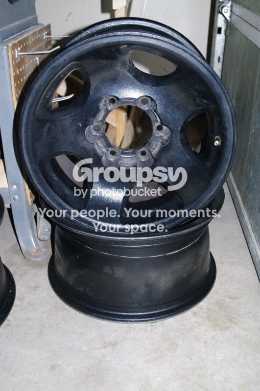

So I actuallyI went over to look at some wheels, can’t wait to get rid of the ones I’ve got. I need to get my Duratrac’s mounted up on something worth mounting them on. I picked up a set of these from him for $300. They're the stock 80 series aluminum rims, and he gets them powdercoated locally. No centercaps, but I'm not too worried about that. This set he ran for a year or so on one of his rigs, but swapped for something different.

Yes they are- they're in fantastic shape, considering he wheeled them a bunch of times. No rock rash, just some scraping on the very edge of the rim from mounting tires. Nothing a touch of spray won't cover. Or a sharpie for that matter. They are a bit dusty in the pic, but they'll shine nicely :D
