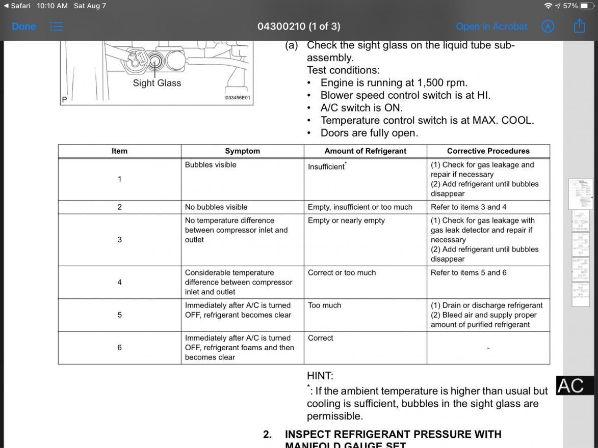

Use the sight glass on the high side. I had the same issuse and just needed to add a few more ounces. But the sight glass makes it easy.

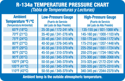

Cycling is a part of how A/C systems work...otherwise they would just build pressure indefinitely. But I gather from your post you know a little about A/C systems. 5-10 seconds sounds like short cycling. It could be from a low charge (perhaps the scale in the AC machine you used is not working properly)... I would keep adding 2 tenths of a pound until you get the low side to about 25psi and the high side at 135 on a 60* day. If it still isn't cool at those pressures, or it is still short cycling you have another issue. Here are the charts I use when diagnosing A/C systems.

Thanks for the information. I ended up recharging it to the max charge level and just running it for a few days. So far it seems to be cooling ok. Maybe the cycling was a function of the temperature. After checking the charts, the pressures seem to line up. Thanks for that!
