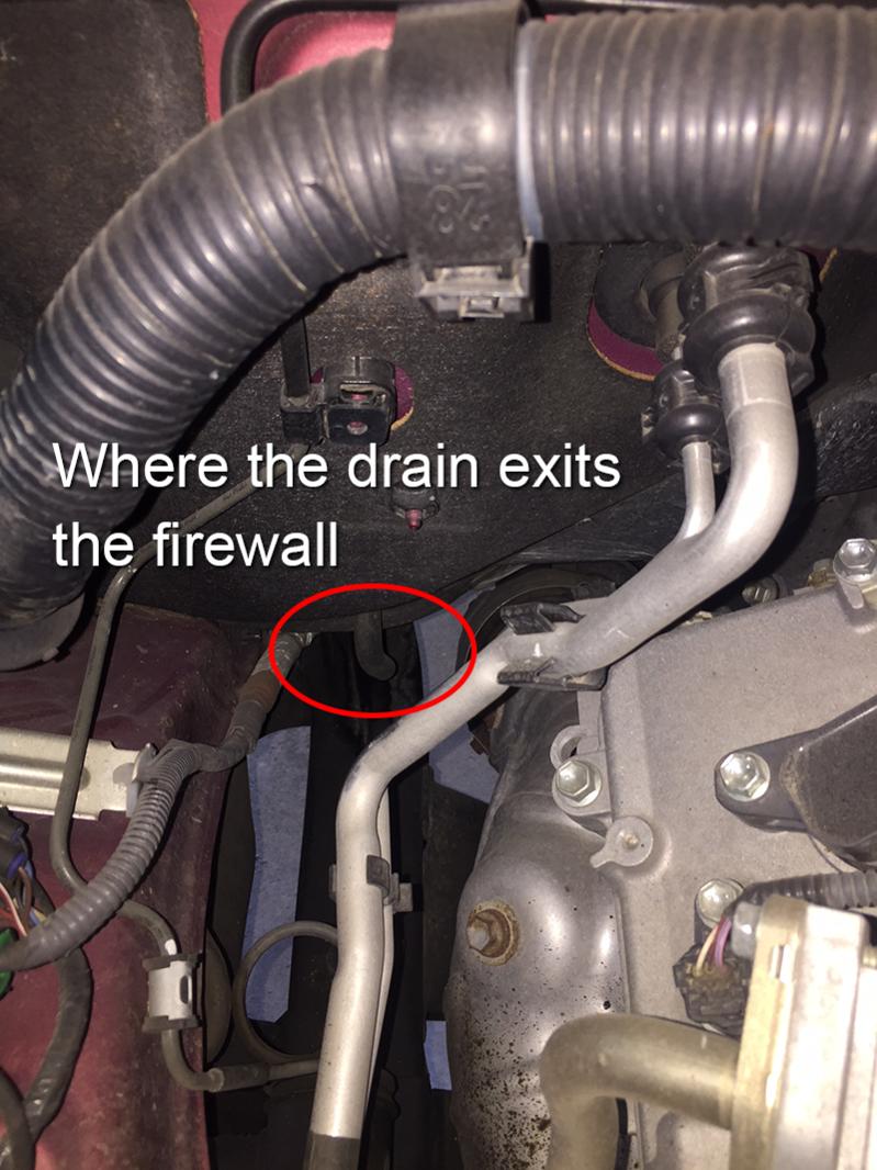

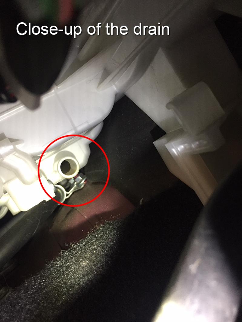

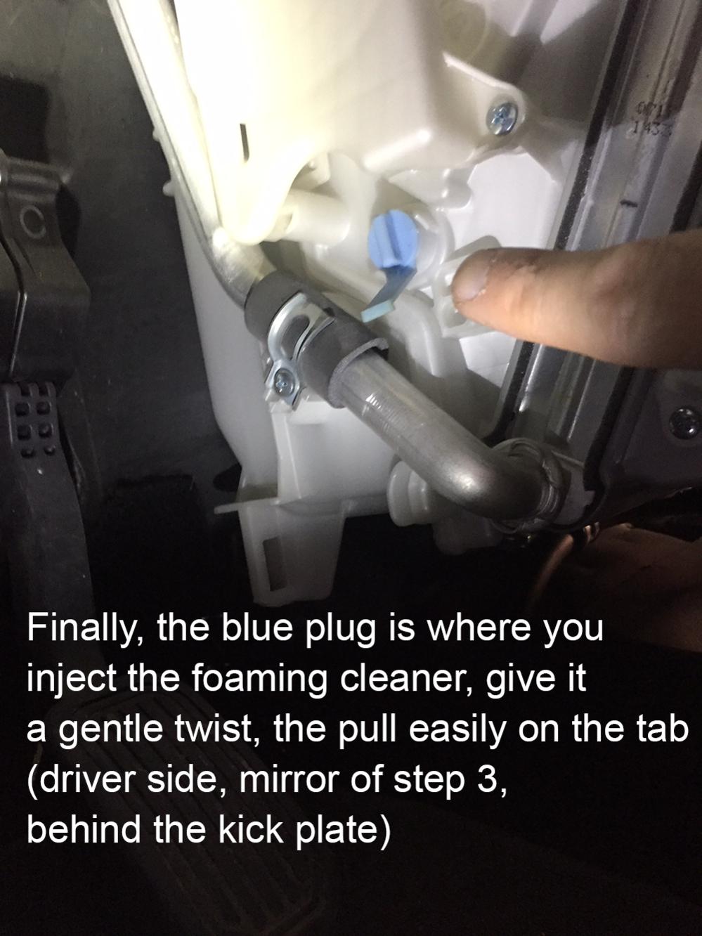

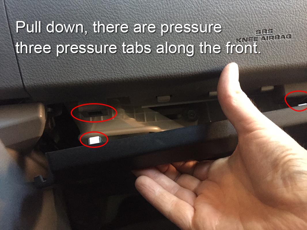

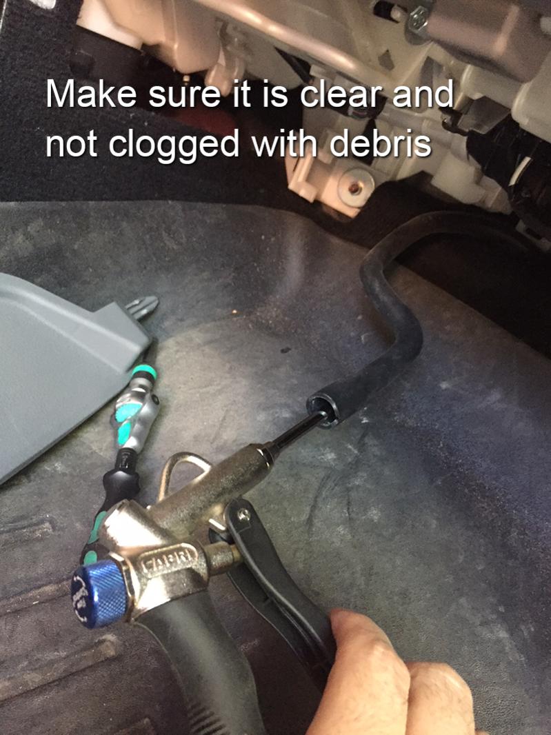

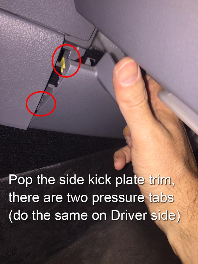

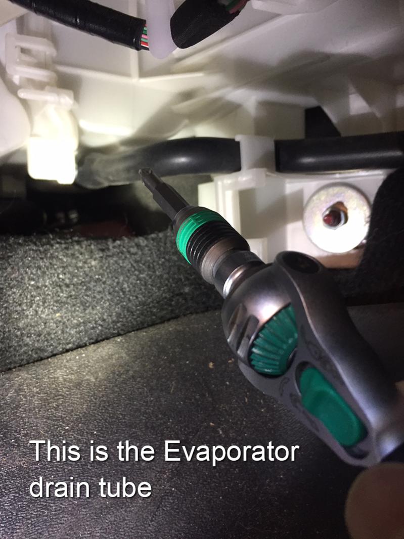

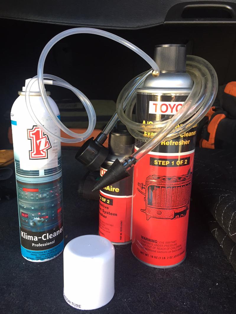

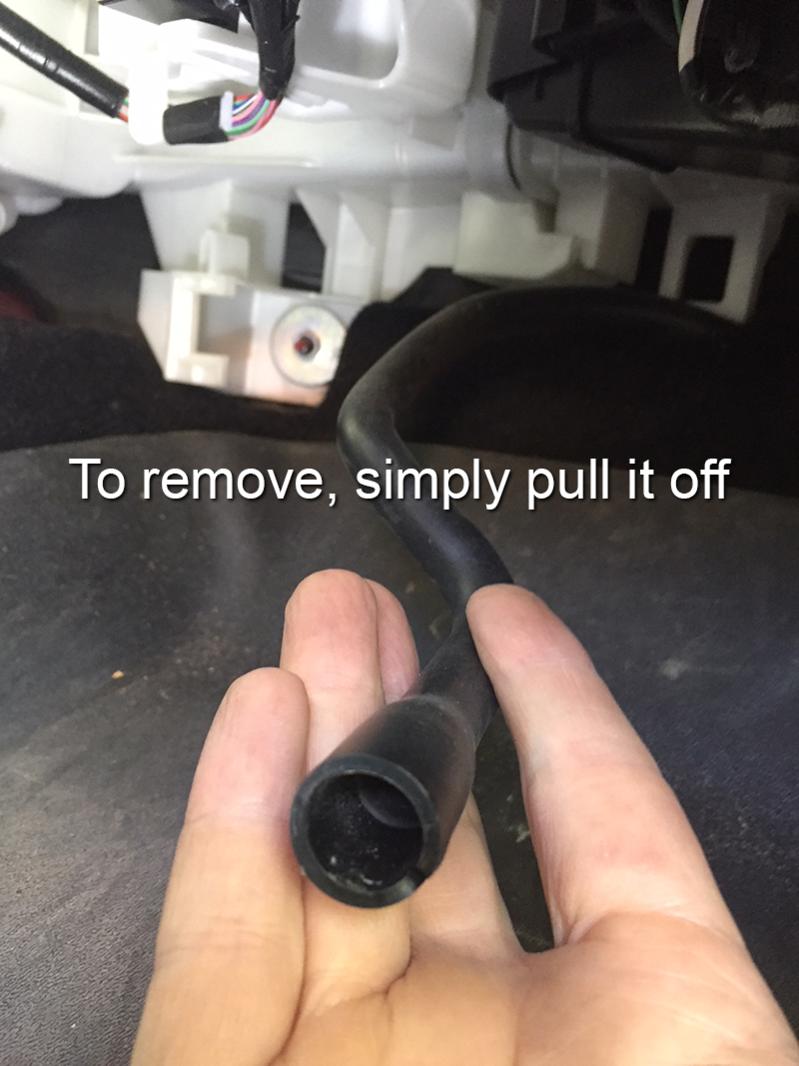

Since it's that time of year, I finally I decided to run some of the wonderful air conditioner evaporator cleaner through that stinky old box and take some pics.
This is just a quick set of pictures showing what to pull and where the key locations are of the A/C evaporator are. Most products have similar instructions so follow whatever it says on what you have bought. I have some 1Z Klima-Klean and the Toyota branded 2 stage cleaner, I have had the 1Z longer so that is what I used this time.
FYI Some more DIY in the thread: http://www.toyota-4runner.org/5th-gen-t4rs/210683-evaporator-heater-core-cleaning-anyone-done.html

The evaporator drain can be used with the Toyota branded evap cleaner. OR you can pull the driver's side kick plate, pull the blue plug and inject your cleaner there.
Anyway enjoy a stank free AC system for at least a little while :)
