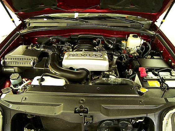

Can u post a pic where this is at? :confused:
drmorbius said:
It's in the underhood fuse box on the battery side. Simply turn over the lid of the box for placement.
i'm still confused. Now where over here?
Sorry no bottle. On mine the sight glass is in front of the radiator between a pressure switch and a service valve on the left side when you are facing the radiator. I have a V6 so not sure where on V8. It's part of a silver colored line that goes to the bottom right side of the radiator, again facing the radiator.
