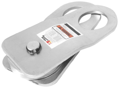

You should also add a snatch block to your recovery gear.

I've read about those, but can't fully figure out what they are for. Mine giving me a dumbed down version?
It is a pulley. It can be used to change direction of pull, increase winch line pay out, and increase pulling power by anchoring to the pulling vehicle with a winch recovery. I carry 2 of them. Pretty useless without a winch, though.
So I don't really need one without a winch? Since I don't plan on getting a winch for a long time, I think I'll keep it on the back burner for now. Thanks!

Keep in mind that while you don't have a winch that the guy that does have one might not have a snatch block. Sounds far-fetched I suppose but I've been involved in enough recoveries to know it can be a mix-and-match of pieces to get the job done.

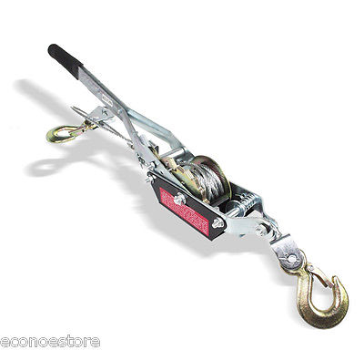

You have a budget winch option, which is a ratcheting cable 'come-along.' Good 4-ton units can be had for between $50-100. I keep one in my 4R along with a longer cable (you'll want more length than the come-along has built in), plus the tow strap and D-ring receiver bar for assisted recovery. Follow the same safety principles used with power winches. Great tool to have, especially if you adventure out by yourself. It has saved me on more than one occasion.
