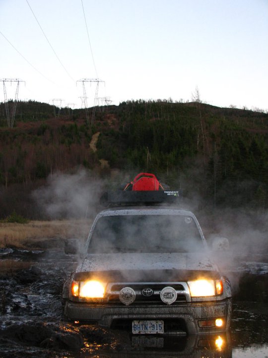

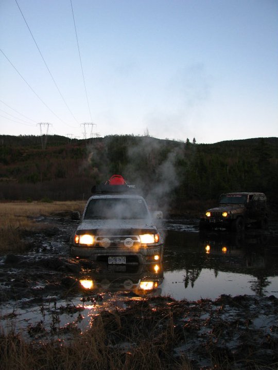

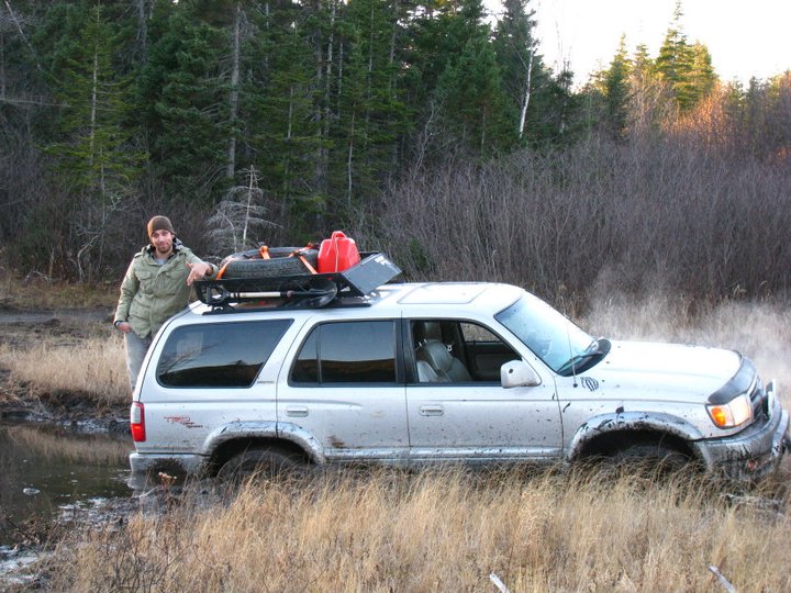

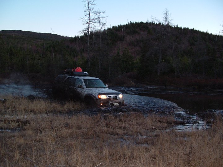

Went for a little sunday drive through the woods with a couple of the boys.
We found ourselves a small bog with some mud :D
After some fun passes through a pretty deep section I finally got stuck :nono:
I tried to wiggle free but as my RPM's came down started to hear a loud knock from the engine. I got winched out and opened the hood, mud and steam everywhere, I needed to get out of the bush so we hurried out. I figured I better just get home and part her. This morning i started her up and drove her to work with the worst knocking squealing noise ever, brought her in the shop and it turns out that 3 out of the 4 nuts on my fan were loose and one was gone, it was wobbling just enough that the noise was transfering up the belt into my power steering pump making it loud. tightend them up put a new nut on and shes as quiet as before!

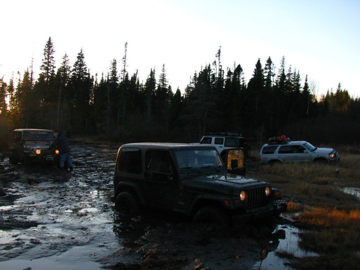

Yea I got razzed quite abit about being the only non jeep. We all got stuck in the same spots, except for the white one....he was alittle more built.
