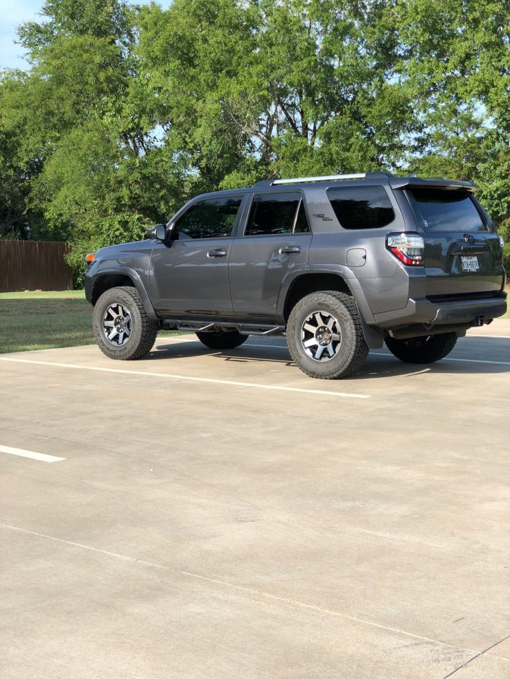

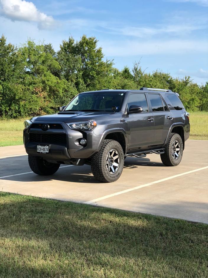

I run 285s on mine with Eibach Pro Kit and stock UCA for awhile now. Picture shows on stock TRDOP wheels and now I’m on aftermarket ProComp wheels with no issues. All I’ve done is the front fender mod. Not sure if this helps you but why not just lift and put the tires on and wait on UCA. I’ve got SPCs sitting in my shop.
