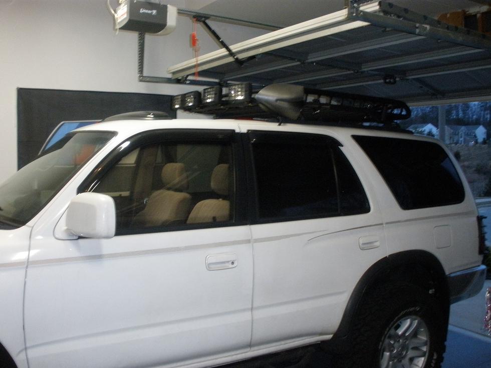

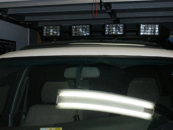

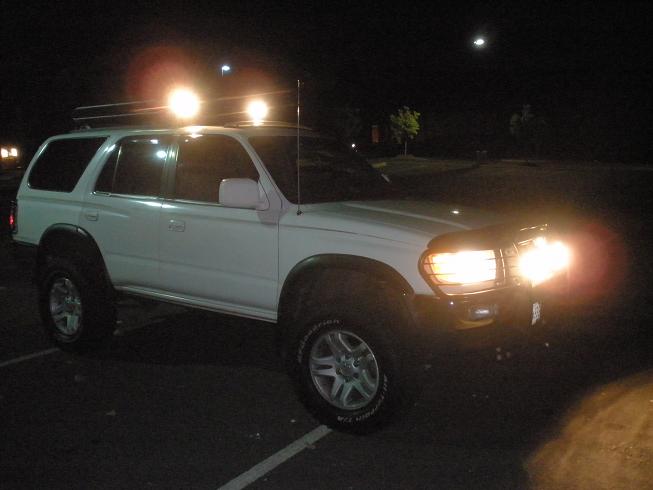

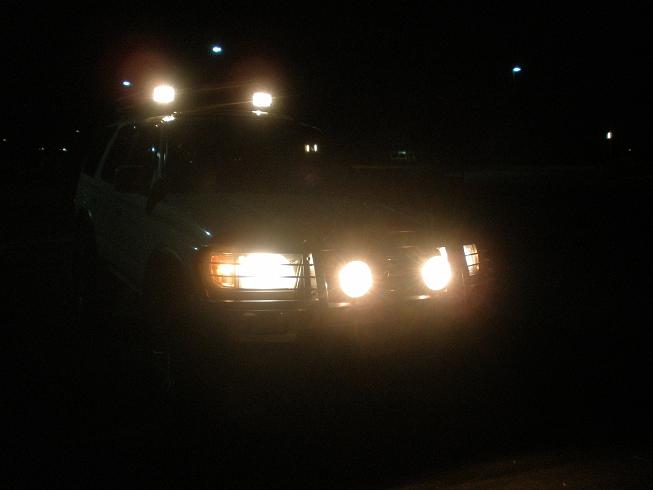

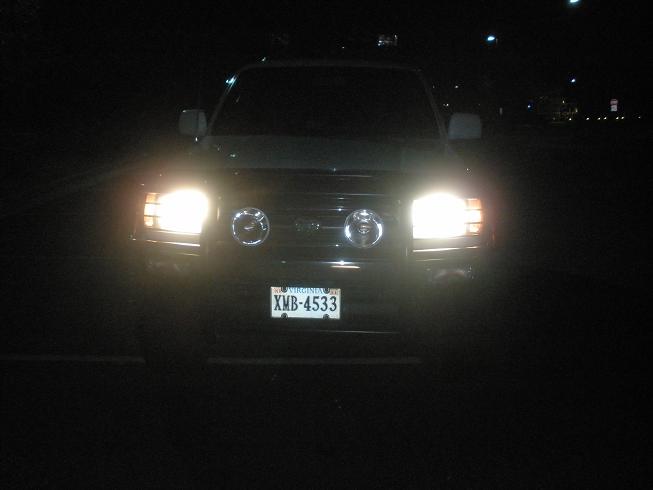

This should have been my build thread... :D Well...After replacing my other lights on my brush guard with Hellas....I decided I'd attempt to mount them on my rack. They were just sitting around in the garage so I gave it a shot. Turned out pretty good IMO. Thanks to JSMarine for his hose clamp idea. Worked like a charm! The lights mounted right up with no issues and I was able to run the wires based on another thread. I can't remember who posted it but I'll find it and definitely give you the credit. I believe it was on Yotatech, but the member may also post on here. I didn't want to drill anything so this route (down the door pillar)was by far the best one for me. I also ordered another toyota fog switch so everything looks factory inside. Now I have two switches. 1 for the Hella Fogs and 1 for the roof rack fogs. I took the Runner down a dark stretch on a back road and hit the lights. I was very pleased with the amount of light generated by them. Could see everything and I didn't have the glare off the hood that some have experienced. I definitely won't be using these lights for the most part unless we are camping and need some extra lighting. Plus, I'd want to get another battery and rewire the lights if I was running these for a long period of time. So in the end...this was a pretty good mod to tackle. I love the look of the lights on the rack and I also wanted them to work if needed as well. You never know when you will need additional light on a dark road in the middle of no where. Here are some pics.

Can you post some pics of the wires job and how you connected them to the rack? Looks good as usual on your 4Runner.

Appreciate the compliment RonMAIDEN! I'll take more pics this weekend. My TG sliders are coming in today so I'll be trying to get those installed and painted. Plus, someone else wanted to see the stance of the truck with the Tundra wheels w/Spidertrax. In the meantime....here is the link I followed for installing my lights to the rack.
http://www.yotatech.com/f2/installed-new-rack-tjm-lift-kit-multiple-lights-pictures-included-111728/

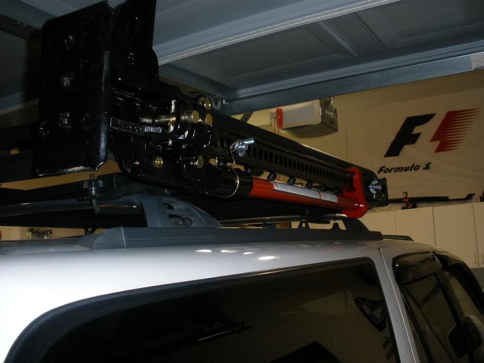

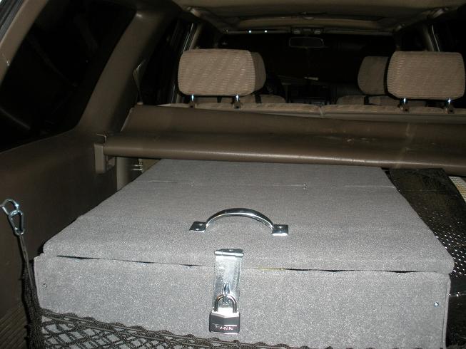

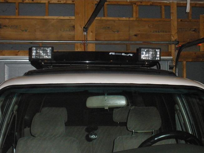

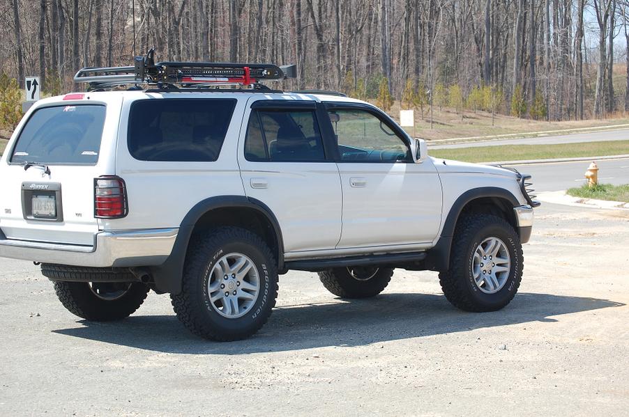

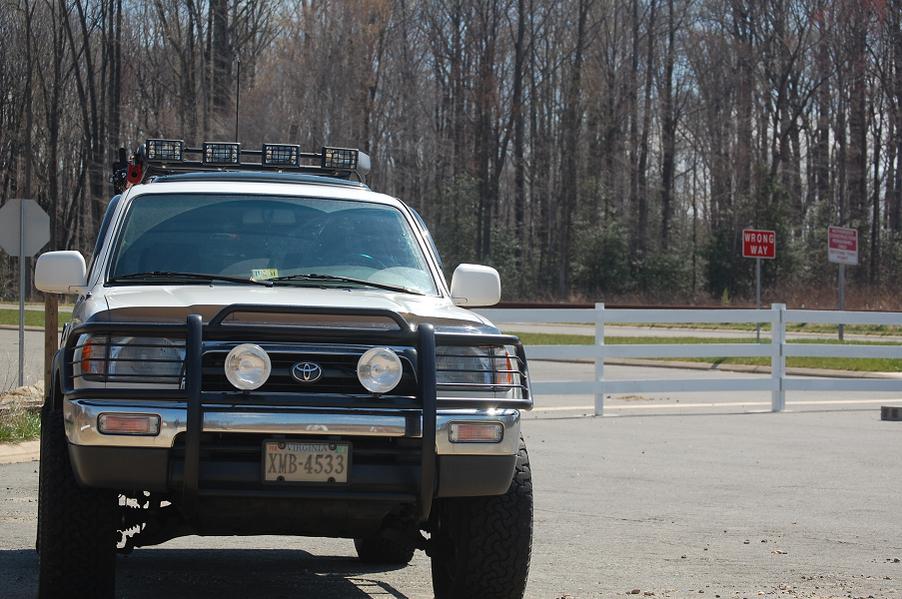

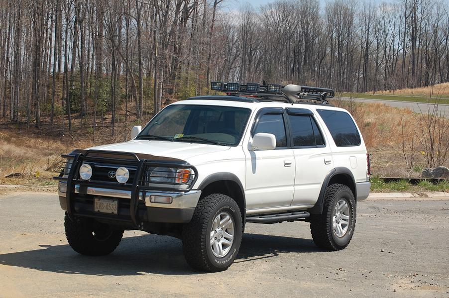

Been a while since I updated this. Really should've made a build thread. Anyway, added two more lights to the front of my rola rack. Looks a lot better now without the spoiler in my opinion. Also, made hi-lift and shovel mounts for the rack as well and built a storage box for the cargo area. It came out a little bigger than I wanted though. May have to put this one in the wife's van and make another. Here are a couple pics but I have to get the others off of my camera after I charge the battery....

Stone - Your Runner is looking super clean! The BFG's/Tundra wheels really give it a great stance! Those wheels work so well on these 3rd gens. Your Runner is an inspiration to my "new" 98! :cool:

looks good man. can u take some pics of how u mounted the hi lift?
I didn't take pics as I was fabbing my mounts together because my camera wasn't charged, but here are the instructions I used. I just couldn't see spending more for the mounts than the Jack so I decided to make my own. The parts I used came to about $12 or so.... Below is the link. Don't kill me....it's from a jeep forum. I did a search on DIY hi-lift mount and it took me to the site. All the credit goes to the guy who did this write up. Saved me from a lot of trial and error.
Homemade Hi-Lift Jack Mount for Yakima roof rack - JeepForum.com

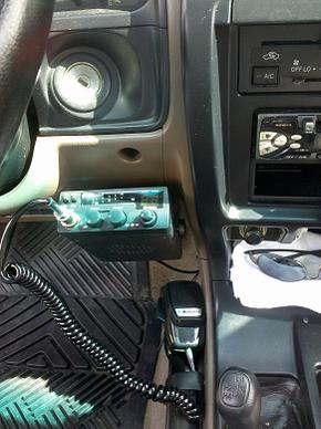

Had a little time last Saturday to quickly install a CB and antenna. I'll post again showing where i ran the antenna wire. It's a magnetic mounted one. I was going to go with the fire stick and buy the antenna mount from Drifter33 but I would've needed to remove my rear tail guards or needed to have the mount customized to fit. These are quick pics of where I temporarily installed my CB and where I placed the antenna. The CB mic is clipped into my Mag-Lite holder right now so I'll be moving that as well. I plan on moving the CB to the slot under my Radio so it looks cleaner and factory when i have more time. The CB works great and already came in handy this past weekend while trying it out. Truckers were warning folks of state boys all over I395. Ha! I don't plan on using it that much really. Just in case I need it in an emergency.
Has anyone come up with a place to hold a handheld scanner? I could put it in the glovebox or my storage box when not in use, but i was wondering if anyone came up with a perfect place to attach it to while driving.
