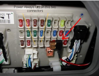

I say you check your fusebox for a hot (always on) fuse then tap into that with the add-a-circuit. Do the same for the ACC in the fuse box, then connect a SPDT switch between the two lines. It's clean and it'll probably only about 10 minutes to install. Just make damn sure you insulate the wires at the switch, I recommend coating them with many layers of RTV after soldering. I wish I had a more detailed answer for you....I will look into this when the temps get above 5deg and I can take going in and out of the truck while installing something...
Why not power to constant 12V power at the fuse. That's what i did.

here is the pic

I forgot about that auto shutdown feature.... I guess I'll just move that add-a-circuit to one of those empty locations.
no copyright on that pic comi, thanks for pointing out the hot fuse locations though.
