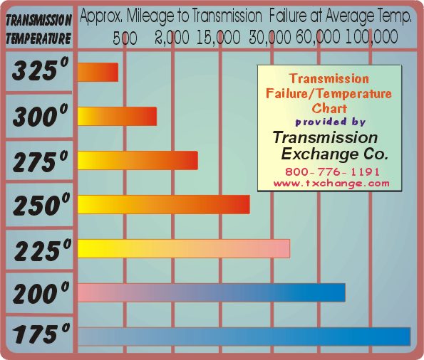

Your truck, your call. Just telling you what is recommended. Heat is what kills Trans fluid.
I'm not trying to argue, and I very much appreciate your input, I'm just frustrated and a bit demoralized now. I've spent so much time and money on maintenance in the last 6 months and it just isn't letting up at all. I love my truck, but it's really ****ing testing my love right now.
What I'm seeing on this chart is that I was over 300F for about .2 miles. This chart is showing averages...which means I wasn't at an average of 300F if I only hit that once in 231k miles. I'm guessing if it smells burnt though, I should toss it if I want this tranny to go another 231k?
If I do another round of drain refills, and if I have some basic Castrol Dex/Merc in there right now (this), can I start draining and refilling with this and be OK (link)
If it still smells sweet then you should be okay. Keep an eye on it. If you feel any slipping or other issues then fluid could be an issue. No arguing, just trying to help you and make sure your truck won't need a Trans down the line.
