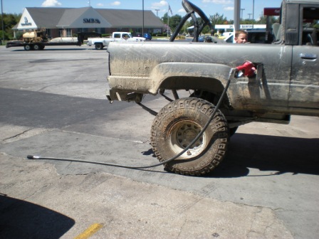

This inst exactly a dumb"question" but,,,, I like to fill up before I go 4 wheeling...
