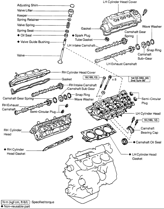

The following doesn't excuse the fact that the shop wrecked your engine....it's more of an informational thing.
The 2UZ-FE doesn't have a lifter in the sense that most are familiar with...ie like in a domestic V8. The adjusting shim sits on it.
While I haven't rebuilt a head off a 4.7, I have rebuilt a couple 1MZ-FEs that have the same basic design.
This pic is of the V6 since it shows better than the V8 one I have. I'll post the V8 one below

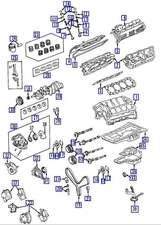

Toyota part number 1375150031
It's #13 in this diagram.
While that diagram calls that a lifter, it's not what a true lifter is, it's a cup that sits on top of the valve and doesn't lift anything, the cam lobe pushes the cup down and thus pushes the valve down which opens the valve, a true lifter sits on the cam lobe and get lifted up which pushes a pushrod up into a rocker arm which pivots and pushes down on the valve and opens the valve.
While that diagram calls that a lifer, it's not what a true lifer is, it's cup that sits on top of the valve and doesn't lift anything, the cam lobe pushes the cup down and thus pushes the valve down which opens the valve, a true lifer sits on the cam lobe and get lifted up which pushes a pushrod up into a rocker arm which pivots and pushes down on the valve and opens the valve.

No not at all, I was just adding an explanation to what the diagram/exploded view of the engine was showing, the diagram will give the OP more info to help him fight them for damaging his engine.
I'm curious of the source of the diagram, is it from Toyota?
I wouldn't think they would call the cup a lifter unless it's something that got worded that way in a translation from Japanese to English.
The V6 one I found online a few years back when I was looking for torque values when doing the head work on my son's car. I had it saved on my computer.
The V8 one is from searching of a lot of online parts sites for exploded diagrams.
