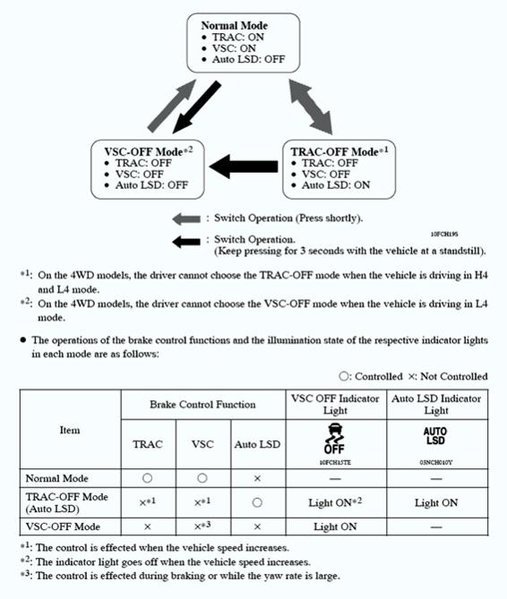

Also some more Tacoma info
tacoma-vsc-jpg.38025
I guess a good question would be, is there a difference between the V6 and V8 system? Being full time 4wd,i wonder if it works differently.
