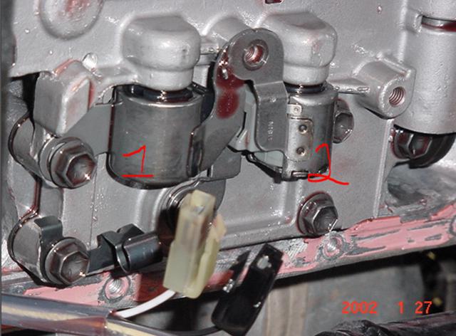

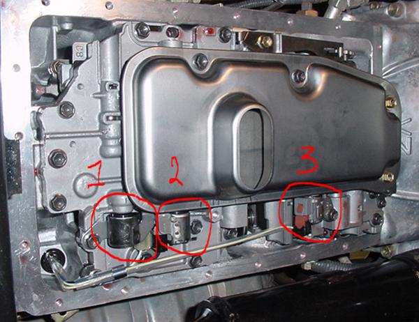

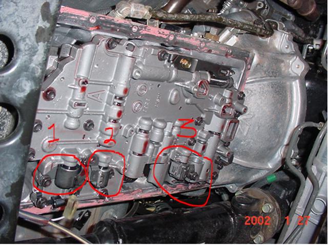

I need some help on to identify the shift Solenoid SL on a 1998 4runner v.6 4x4
When I took off the VB and did my ATF I saw that there are two shift Solenoid
Now my CEL comes on throwing a (P0773 Shift Solenoid "E" Electrical)
and a P0770 (Shift Solenoid "E") P0773 stating that is is the shift Solenoid SL (TDC #1)
My question is which one is the Shift Solenoid SL, can anyone give me an idea
here are some photos not my came off a 2000 4runner limited.
2002 4runner Shift Solenoid "E"
This was posted a long time ago but I am also looking to locate my shift solenoid "E" or solenoid SL. Can someone please help me locate it in the photos above? Will my 2002 look similar to this 1998 pictured?
Thanks....
Hope this helps a little!
Photo came from a 1998

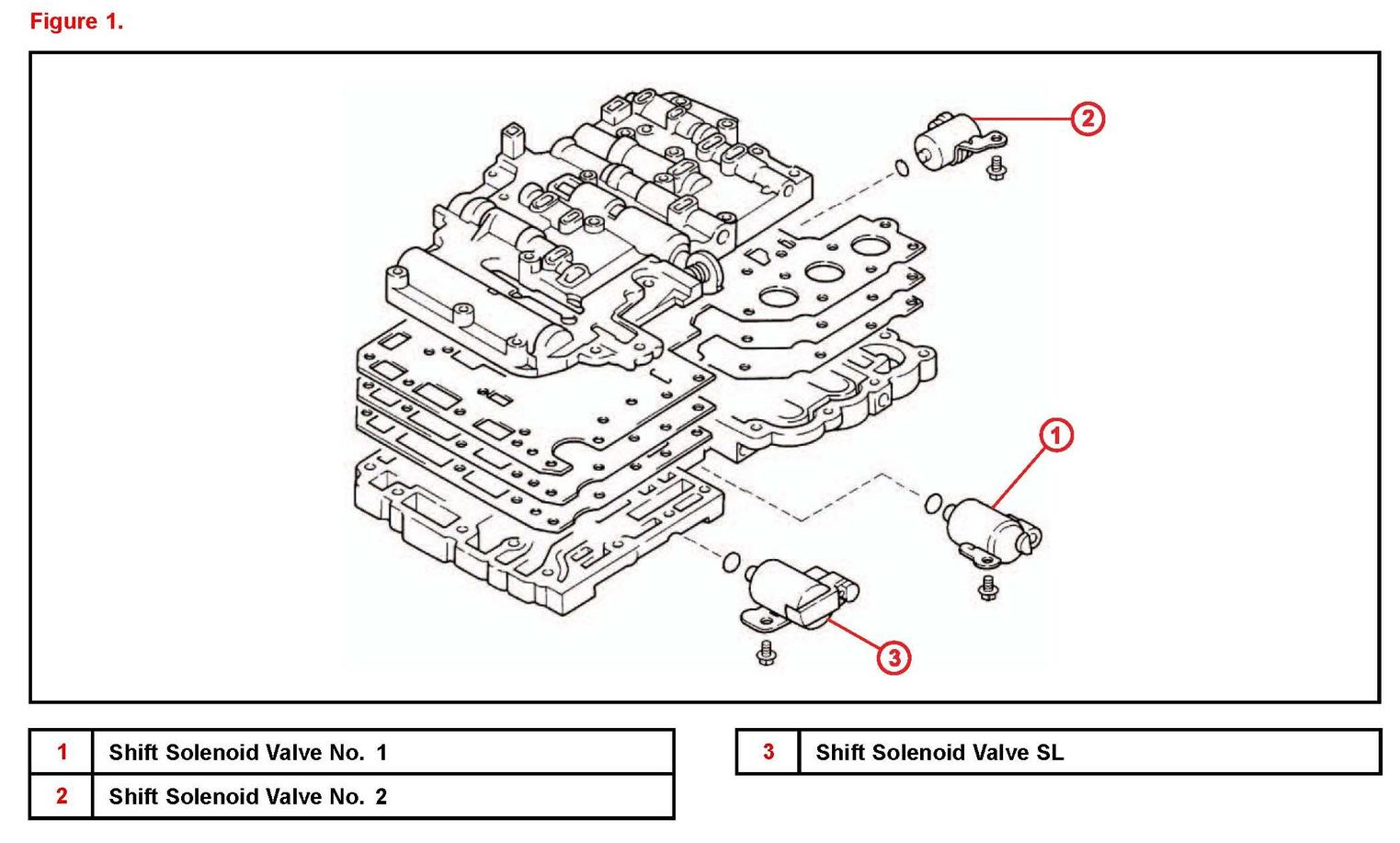

looking at the first diagram posted by the OP, is the solenoid labelled #3 the shift solenoid SL and what cause the p0773?
