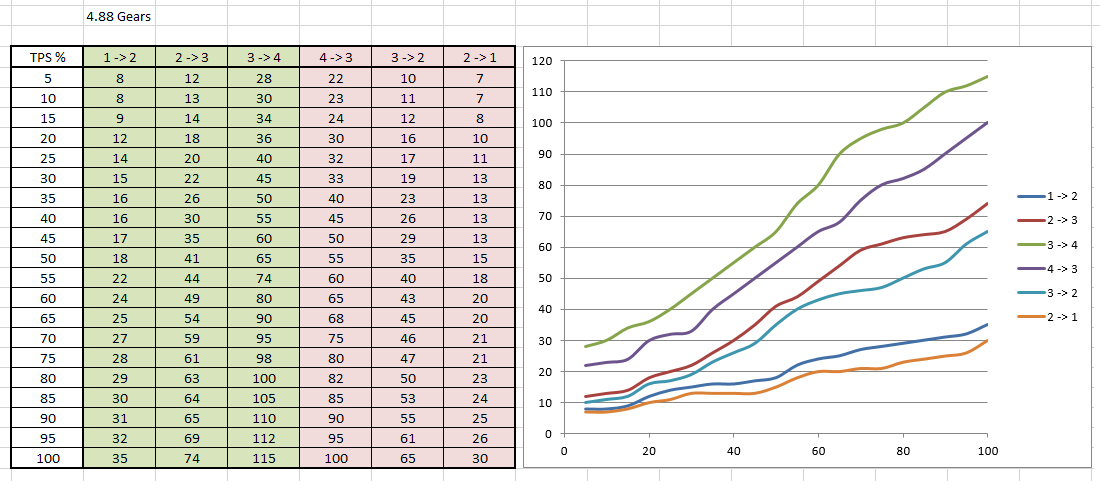

I thought it was pretty easy to wire up, Instructions Here
It basically operates on throttle position vs vehicle speed, so splice it into the speed sensor on the output of the gearbox (Pre transfer box).
RPM is also there, but its only really used for a shift light and over rev protection.
It took me a while to get my shift points where I liked them, and I redid it when I re geared to 4.88s, but it's treated me well over 3+ years.
Attached is my last map.. this is for a truck running a VVTi 1UZ, 285/75/16 and 4.88s. I might tone down the kickdown kinks at about 20% throttle a bit in 3rd and 4th, but I've got used to it now. :D

How are you measuring TPS? My DBW pedal from the TDI has two potentiometers, one rising and the other falling. I just don't know the voltage output of these sensors. If the range is outside of acceptable for the SS, do you know of a universal TPS that would work? This might be a better question for the Latent, but I fig'd I'd check with you in the meantime.
