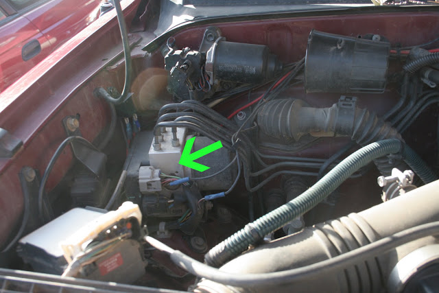

1. Locate the wire harness on the ABS actuator which is behind the airbox.

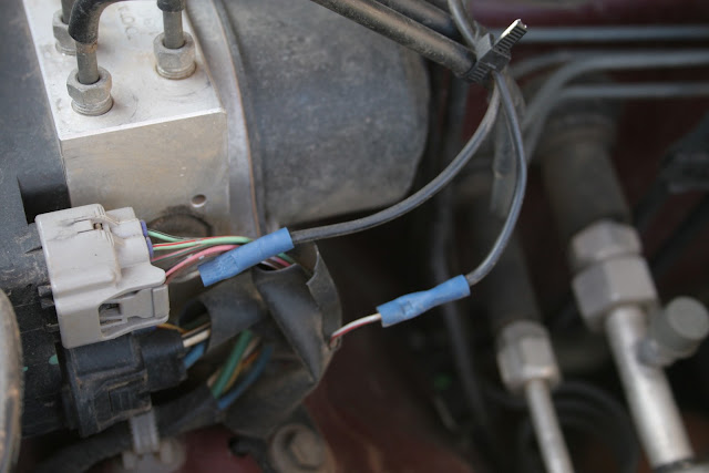

2. Cut the gray/red wire and crimp a wire to either end of it
IMG_2867.JPG~original
3. Run the wires inside through the firewall and connect them to your On/Off switch.

I have been looking in to this and after studying the wiring diagrams, you don't need to pull wires through the firewall. The gray-red wire that is usually cut at the plug under the hood can be cut near the same spot the yellow wire is cut, at the ABS computer. The yellow wire is in the larger of the two plugs, A17(pin #10). The gray with red stripe connects on the smaller plug(A16) to the ABS computer at pin #16.
Hopefully this will help with not having to punch wires through the firewall.
