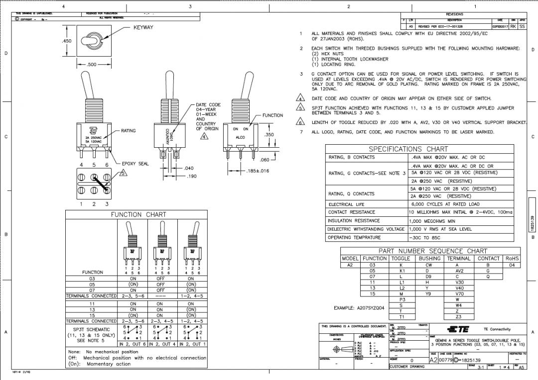

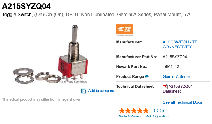

1. One "DPDT (on)-on-(on)" Toggle Switch (e.g. ALCOSWITCH A215SYZQ04)

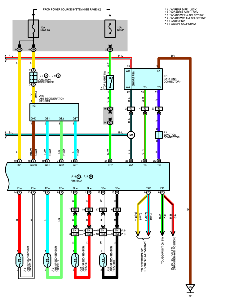

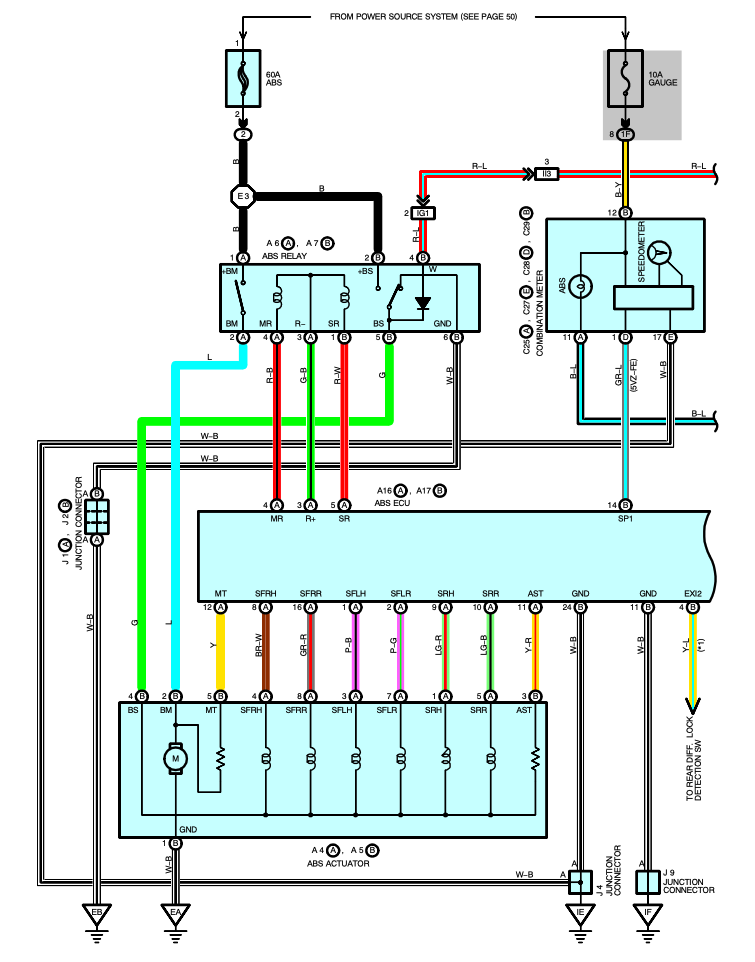

1. To turn ABS OFF (and illuminate the ABS dash warning light), we will temporarily interrupt the Signal between the ABS ECU and ABS Actuator (with a switch). See wiring diagram, gray/red wire, GR-R (A16) between the ABS ECU and ABS Actuator.
2. To turn ABS ON (and turn off the ABS dash warning light), we need to make sure the Signal is connected, and then temporarily interrupt the Power to the ABS ECU (with either a vehicle restart, or a switch). See wiring diagram, yellow wire, Y (B10?) to the ABS ECU.

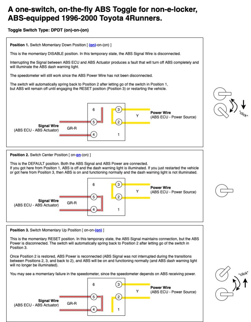

That's it. We'll use a DPDT (on)-on-(on) switch. It's a three-way toggle switch, where the Up and Down positions both spring back to the Center position. See Switch wiring diagram with descriptions.
With this method you simply click the toggle Down to disable ABS and click the toggle Up to enable ABS.
Since the toggle always springs back to the Center position, it's no problem if you forget to turn the ABS back on after riding a trail: every time you start your truck, ABS defaults to ON and is working normally.

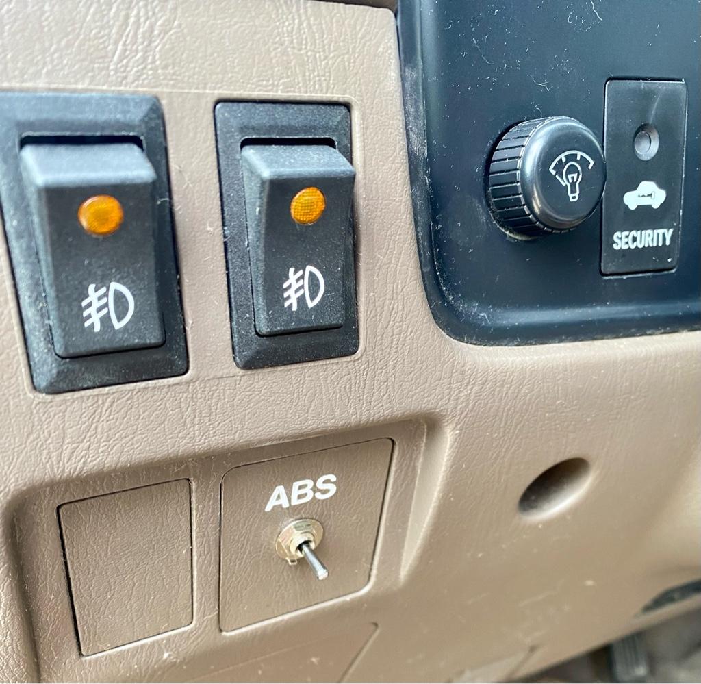

I wired up the switch with a pigtail and mounted it. I haven’t tapped into the ABS ECU yet. I just had a minute this morning so I popped off that panel cover, drilled out a hole for the switch, mounted it, and applied little vinyl letter stickers.
(I’m saving that remaining standard size blank for a rear locker…)

Also, I’m considering using a bigger switch with a higher rating. Maybe someone with more electrical knowledge can tell me if the switch I linked to in the first post will handle whatever current will flow through it.
Just a warning: I haven’t finished doing this on my truck yet, so I haven’t fully tested it. (Although I can’t see any reasons why it won’t work.)
Please feel free to add to this thread if I missed anything.
5 Amp switch contacts.. As long as these ecu require less then 5 amps your good. If not, then it's the wrong switch for it.
