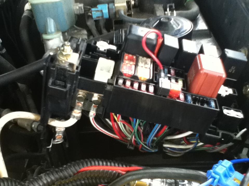

I needed to disable my ABS, but couldn't get the fuse out so just popped the cap off and cut it.
For the life of me can't seem to pull the old fuse out to replace it. Am I missing something or should I just pull harder? Or do you have to take the fuse box up and remove something underneath?

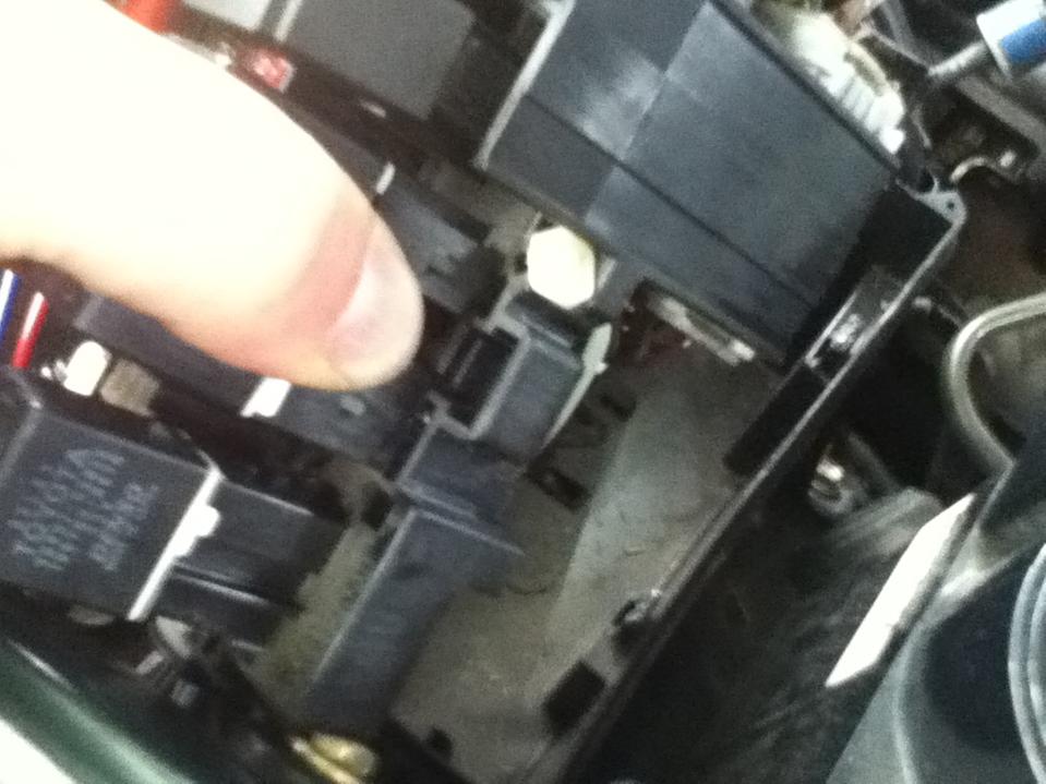

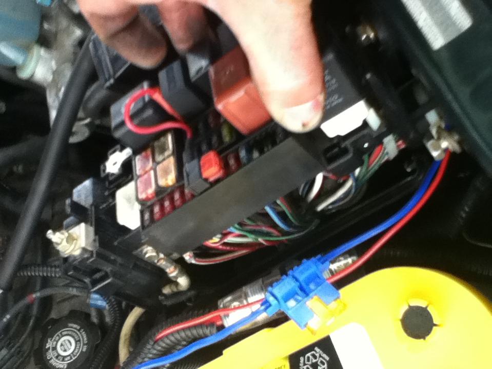

Yeah, its screwed in from underneath. And assuming your 2000 is lile my 2000, dont bother unbolting the box from the fender as the business part of the box actually comes out of the case. I have some pictures on my phone, give me a few and ill figure out how to get them off and post them.
here you go, hope these help. there is 4 little tabs securing it in there. kind of a pita to get all 4 to release at once. also be careful of the air lines coming off your charcoal cannister right there. i accidentally broke one of mine off, its pretty fragile and not a cheap fix to replace the canister.
