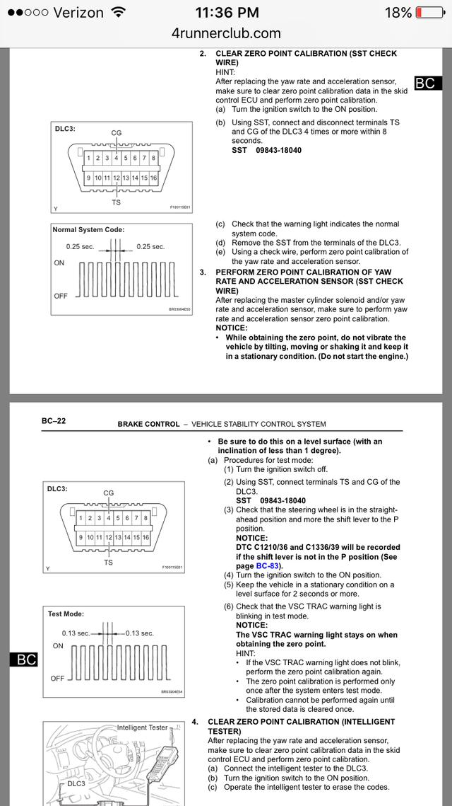

Note the orientation of your obdII plug. Mine was upside down from the fsm picture. #2 & 3 to clear and calibrate. Easily done with 2 small wires or paper clips
