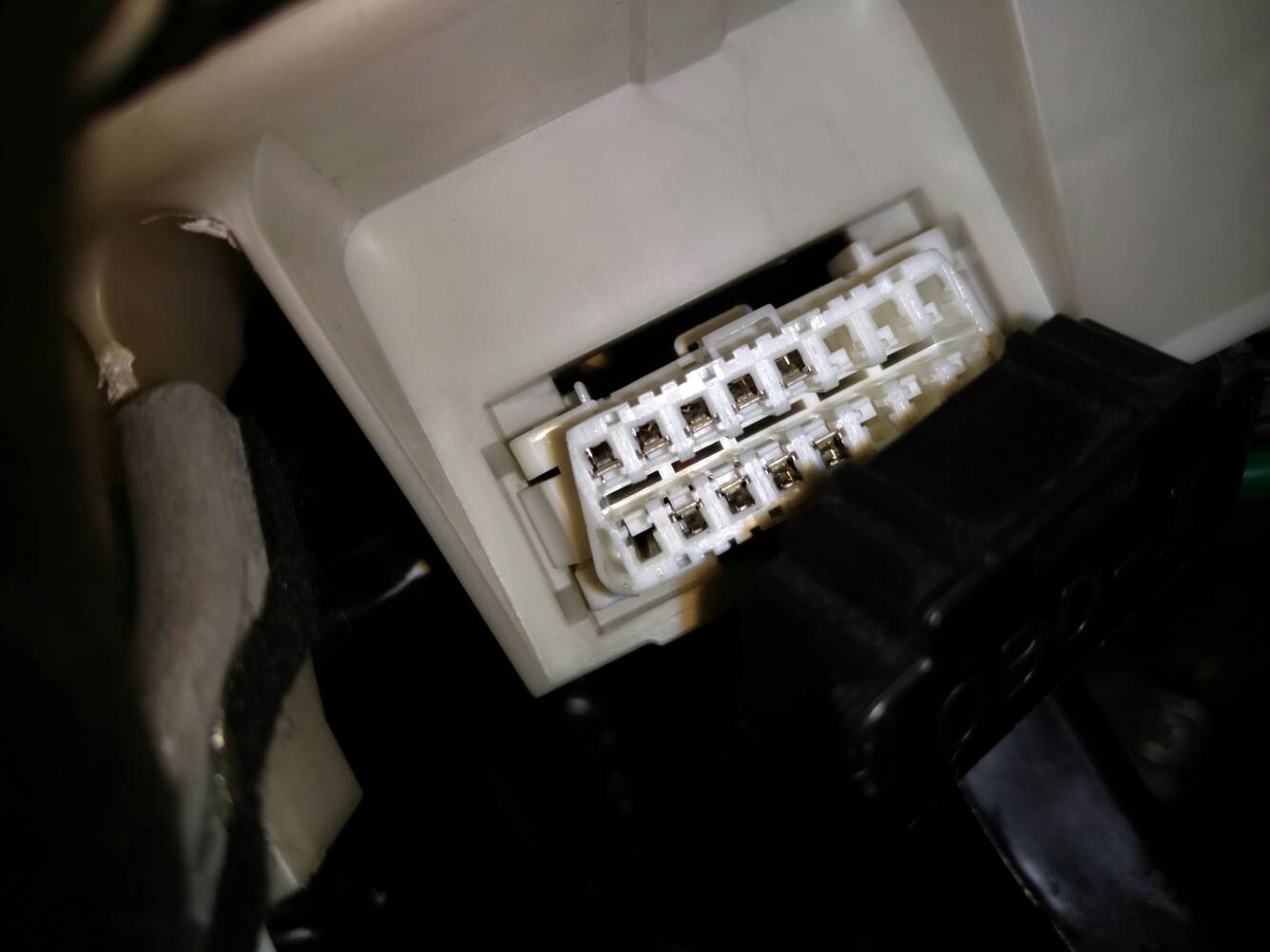

Do note that my OBD port was upside down. This picture was taken right side up
Sent from my XT1575 using Tapatalk

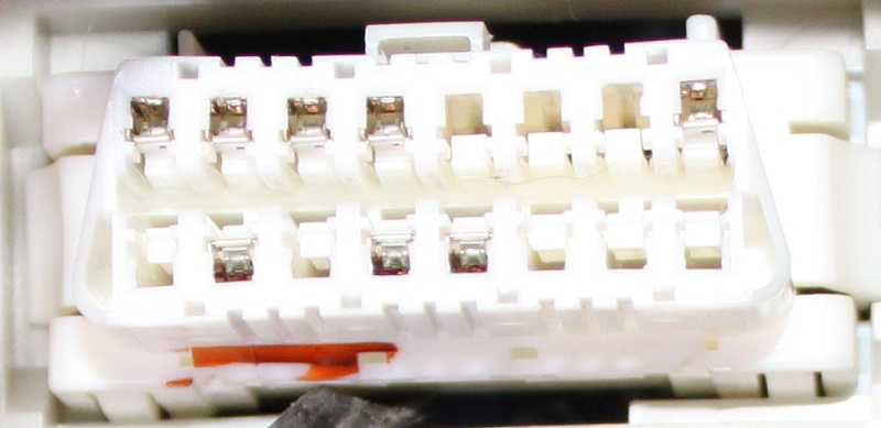

I finally got around to this and noticed my DLC3 (under dash plug) had no pin in the #12 slot.
Some more reading around here lead me to try pin #14 for 2003-2004 models.
Seemed to work just need to test it in the dirt.
This is some good info.
http://www.toyota-4runner.org/probl...ac-vsc-off-lights-zero-point-calibration.html.
Info from above...
Parked flat and level, steering wheel straight.
1. Ensure the shift lever is in Park.
2. Turn the ignition switch ON.
3. Using SST 09843–18040 (paper clip), repeat a cycle of short and open between terminals Ts and CG of DLC3 4 times or more within 8 seconds.
Verify that the VSC indicator light is lit indicating the recorded zero point is erased.
4. Turn the ignition switch OFF.
5. Be sure the terminals Ts and CG of DLC3 are disconnected.
6. Turn the ignition switch ON.
7. Check that the VSC warning light goes off about 15 seconds after the ignition switch is turned ON.
8. After ensuring that the VSC warning light remains OFF for 2 seconds, turn the ignition switch OFF.
9. Connect the terminal Ts and CG of DLC3 using SST 09843–18040.
10. Turn the ignition switch ON.
11. After turning the ignition switch ON, check that the VSC warning light is lit for about 4 seconds and then starts quick blinking at 0.13 second intervals.
12. After ensuring the blinking of the VSC warning light for 2 seconds, turn the ignition switch OFF.
13. Remove the SST from terminals Ts and CG of DLC3.
Drive the vehicle to confirm there are no re–occurring lights or DTCs.
