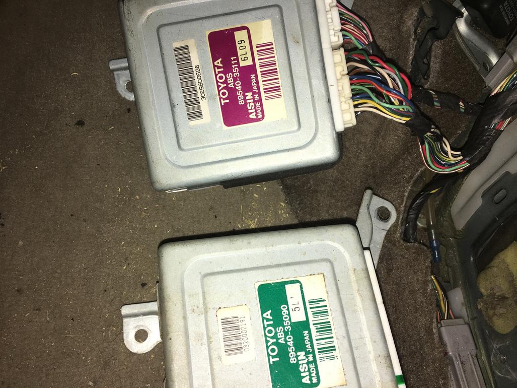

So I kinda feel like a dumbass but I found my ABS issue. Whenever I removed all the stuff behind the dash to change out the wiring harness I must have put in the wrong ABS controls module. I thought of this yesterday and swapped them out and everything works as it should. Thanks to all those who helped me though
