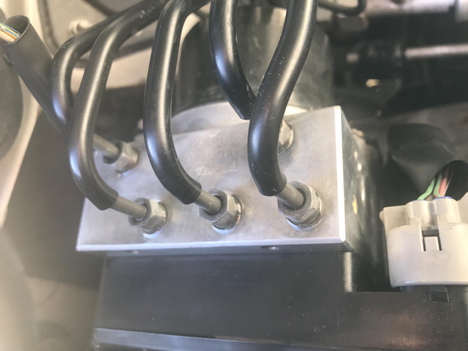

Hopefully someone can shed some light on this issue. I was getting a sinking pedal and replaced every component in the brake system with new OEM parts over the past two months and still getting a sinking pedal. After doing research on here I found that the ABS pump was most likely the problem even though there was no ABS lights on dash. I bought a used pump off eBay and replaced it this morning. Brake seemed to get stiffer, but after looking under the hood there is fluid coming out of every fitting on pump block?? See picture
Any clue how this is possible?? All fighting are plenty tight.
