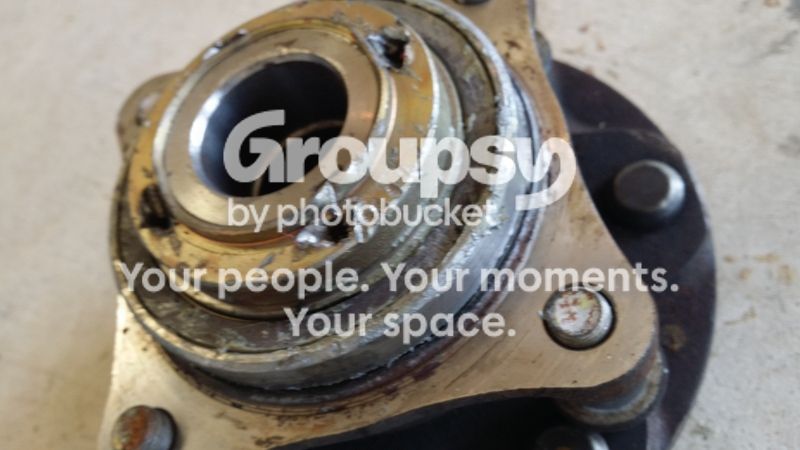

This is what I found when I swapped them out. Holy moly, they weren't kidding when they said it was damaged. It was also soaked all over in what looked like anti-seize compound. Time will tell I this was really the problem but if it does turn out that way, I'll be taking this back to the tire shop that did it and seeing if they offer a refund for the work they did since I had to redo it.

wow! I can't understand what the deal is with those 4 punch holes... It looks like it was hit with a drift, but the way the metal has sheared makes it look like it was hit from the opposite side that would be necessary to free it from the spindle...
yeah, all four have definitely been hit from both directions. If they struggled getting it off then fair enough, but at what point do you mangle something to the extent that you just get a new one instead of putting it back together and giving it to the customer that way?
Since I bought the bearing/hub assembly from nj636 I didn't have to do the separation work and don't know which parts come with a new bearing and what's reused with the hub...does that ring come with the bearing or the hub? Said another way, is that the ring that would have been on it before they replaced the bearing and has to be reused, or is that a ring that came with the bearing and they mangled it putting it back together?

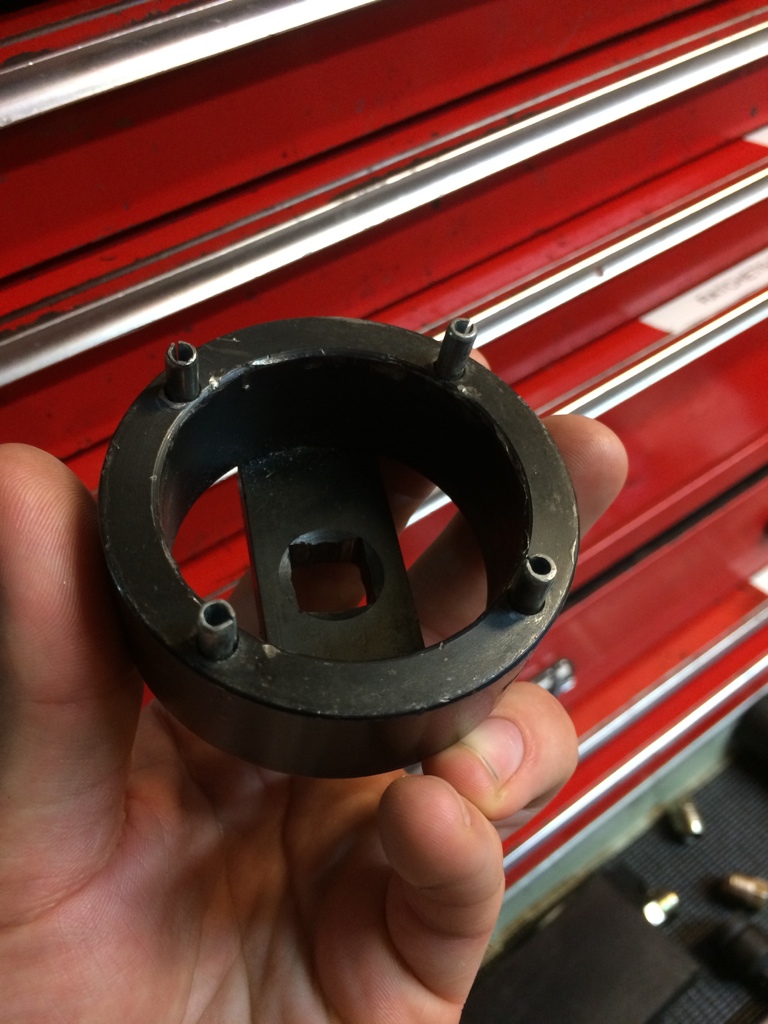

they obviously didn't have the SST to remove that nut. Some shops will use an air chisel to remove and reinstall the nut -- how can you torque the nut to 203 ft/lbs with an air chisel :noidea:
wow, that's exactly what it looks like! Good (and scary!) point on the torque. I'll be sure to ask them about that when I go in.
Unfortunately my wife lived 130 miles away when this happened so it's not like I can just go up there during my lunch break. We'll be back in town visiting family on the 29th so I'm going up there then.
