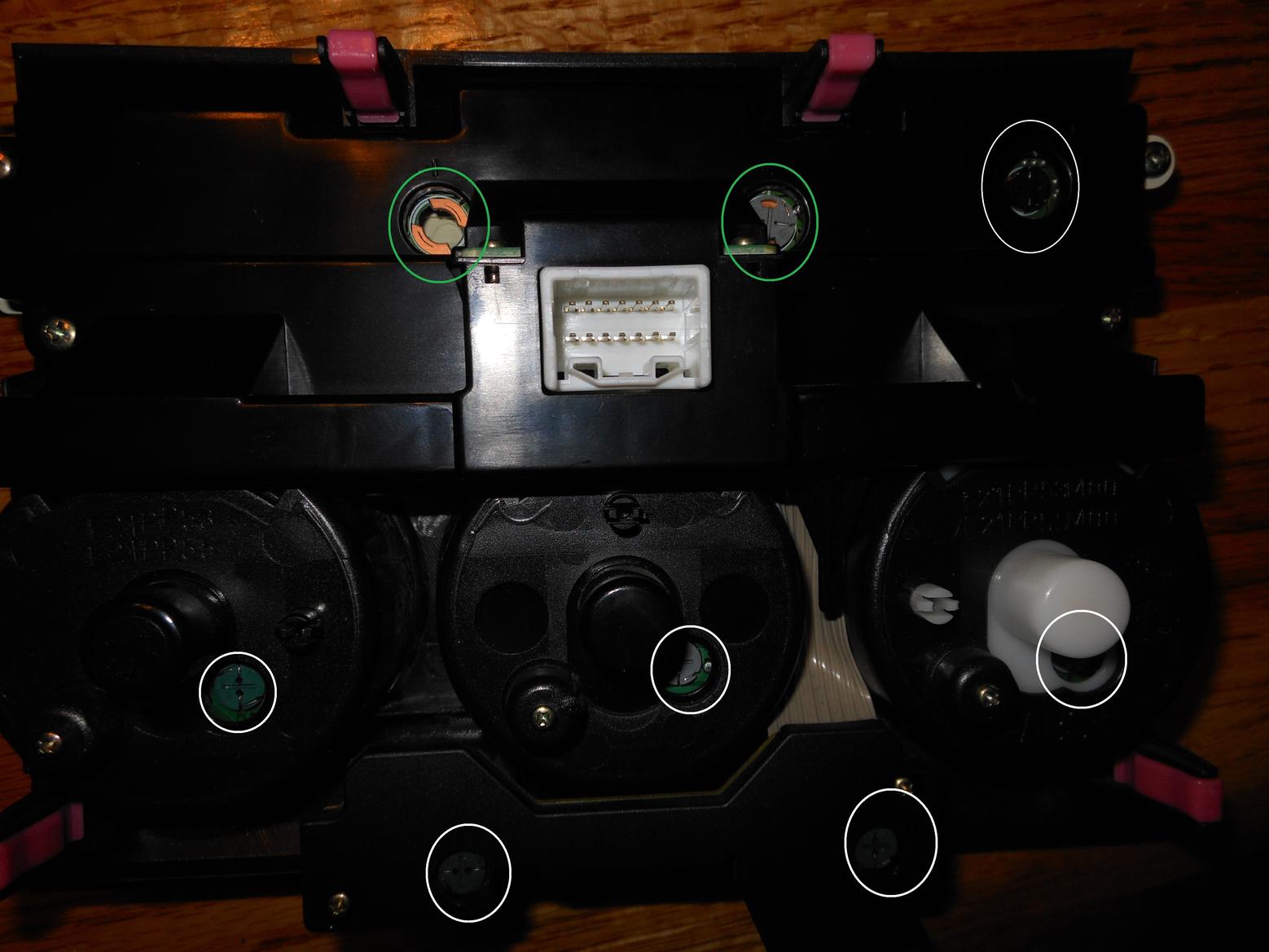

Hey guys, I'm having light bulb issues too. The right half backlit display above those knobs has gone out. I've taken the panel out to access the bulb holders in the back of the panel, and sure enough, the tiny bulb's filament is broken. (Just the the right side of the backlight went out; the display/time still works.)
Has anybody found stock replacements for these bulbs?
I'm also thinking of getting some white LED's from Radioshack and replacing the two for the backlight-display.
Here's some images for reference:
The two green circles are the spots for the orange backlight bulbs, all the others in white circles are for other bulbs and different locations. I just want to replace the two green circles with LED's or stock bulbs, if anybody knows where to get them.

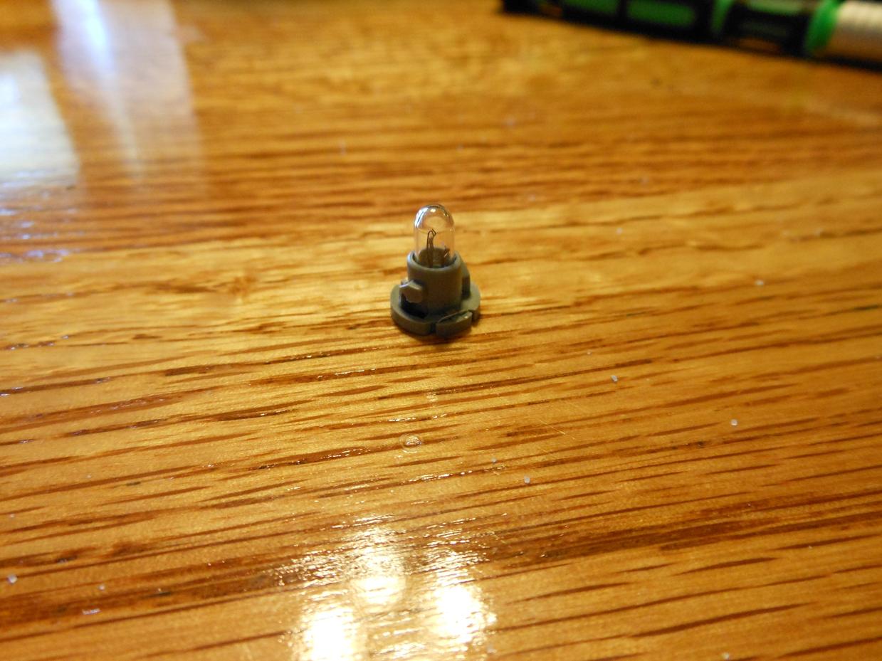

I just got back from RadioShack and I could not find a proper sized LED or incandescent bulb. I've been reading other threads about replacing interior cabin and map lights with LED kits sold online, but I doubt those retailers carry anything this specific.
Here's a picture of the stock (burnt out) bulb in the holder.
