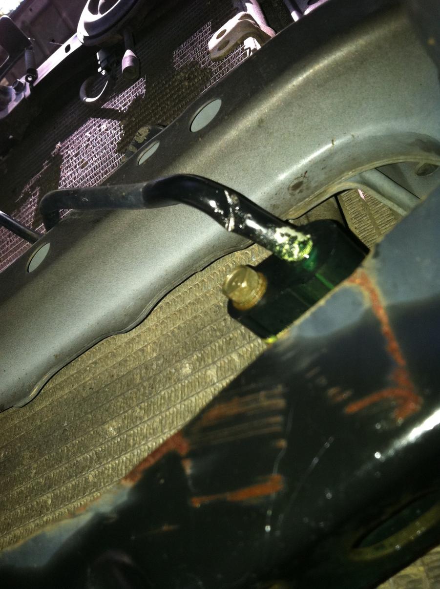

They spotted the leak, a cracked "liquid line" aka refrigerant line from the receiver/drier to the radiator. Of course, they wanted $280 to fix it, quoting the line itself only available at a dealership for $120.
Now, this seems to be something more I could handle. I'm assuming the line is a pressurized line, so if all the pressure isn't out already when I go to take it off am I going to relieve the whole system and spray freon everywhere?
If so, can I cut off the pressure somewhere to minimize freon loss, replace then line, release freon flow, and top it off?
That green stuff is the UV leak detector. With a leak that big, there is no more freon in your system. Just replace the line from one from a junk yard, bolt it on and put in 2 cans of freon and you should be all set.

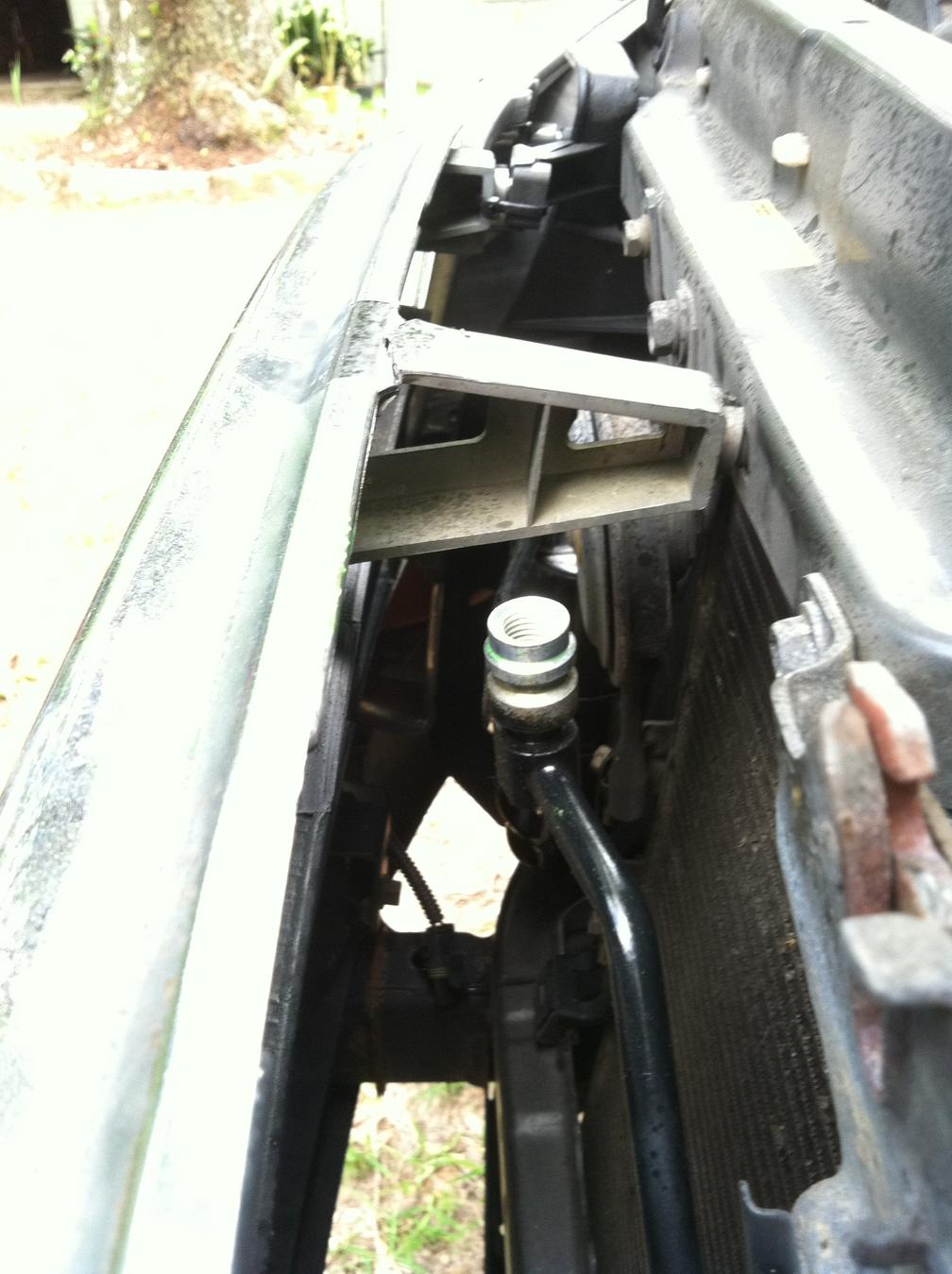

Did some poking around today and I pushed the pressure relief outlet, let's just say it's still charged still has liquid in it.
If your ac doesn't work anymore, then you don't have enough freon to really matter. The AC system will function (although quite poorly) with as little as one can (12oz). If yours doesn't work any more then your have very little left in it.
Keep it sealed up until you get your new line. Once you get it, release the remaining amount by hand it will probably only last a few seconds. Remember that the system could equalize over night but when you run it, the condenser will get hot from the radiator and will increase the pressure in the ac system.
