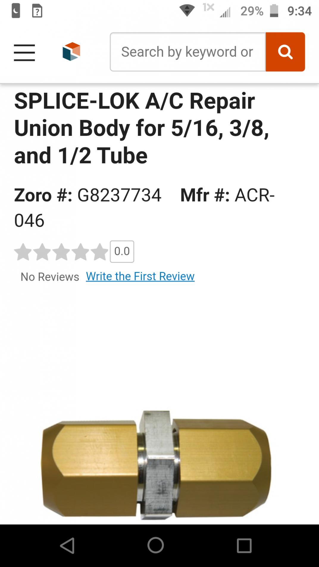

Well, I thought I had my AC lines all good with my new bumper, but looks like it vibrated through this morning somewhere in the San Juan mountains :( caught it before my AC got low enough to blow warm, but I've still got a hole in an AC line.
Has anyone successfully used a splice kit on a 4th gen? Would be very convenient to just splice the line and refill the system... Or do I need to replace all the hard lines? Or just bend over for the mechanic lol?
Splice it for $15 in ten minutes.
