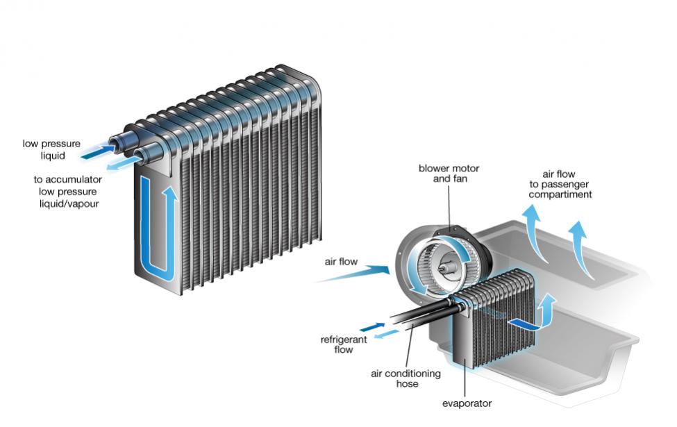

what is meant by double loop? is it a good design? I recently saw an evaporator from a 2012 Hilux. it's wider but the thickness is less than half of the 4Runner's evaporator..
Double loop loose terminology, double pass through of freon, unlike radiator. Great design.
Hilux - more surface area less thickness, material cost, bean counters and engineers.
