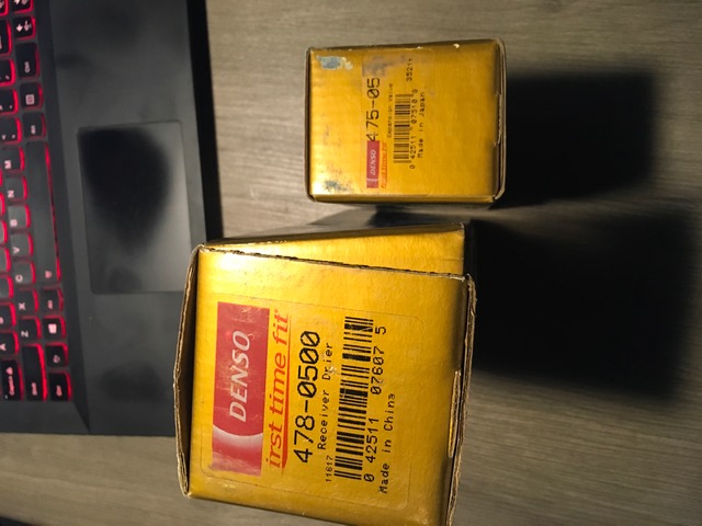

With it being open to the atmosphere for so long since you punctured it, I would recommend keeping it on a vacuum for several hours, if not overnight after replacing everything. Every bit of the moisture needs to be removed. The factory Denso A/C compressors aren't really known for failing. I'm sitting at 287k miles right now on the factory compressor, and it will freeze you out. It could have been something as simple as the High/Low switch failing that caused your A/C problem in the first place. I would recommend using a paperclip as a jumper where the High/Low switch is to trigger on the A/C compressor. I went through an A/C issue 2 years ago. The compressor would not kick on, so I automatically assumed that it was the compressor. After jumping the high/low switch though, the A/C would blow cold like before. Unfortunately in the 4runners, they decided against using a schrader valve on the high/low switch, so the entire system has to be evacuated in order to change the switch. I had already anticipated replacing everything in the system and had even bought a few new parts. Being that you don't know exactly what it was that failed, I would replace everything except the compressor if it passes the jumper test. I have a brand new in box drier and expansion valve if you're interested. Both are from Denso, and still in the factory boxes. Part #'s 478-0500 for the drier, and 475-0505 for the expansion valve. I'll let them go for $35 shipped for both. Just let me know!
