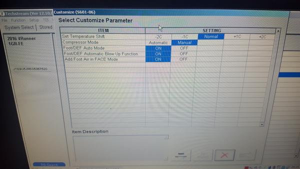

Not at this stage can you rule out this stupid setting.
Older models around 2010 should be able to shut down.
And I am annoyed but there is no such option in my 2016 limited.
In this manual it says it can for older models.
Air Conditioner
Display
Default
Contents
Setting
Set Temperature Shift
Normal
Function to set the temperature shift.
+2 C/+1 C/Normal/-1 C or -2 C
Compressor Mode
Automatic
Function to turn the A/C on automatically by pressing the AUTO button when the blower is on and the A/C is off.
Automatic or Manual
Air Inlet Mode
Automatic
Function to automatically change to recirculation mode when the A/C is turned on.
Automatic or Manual
Foot/DEF Auto Mode
ON
Function to turn on the airflow from the front and rear footwell register ducts and front defroster automatically when auto mode is on.
ON or OFF
Foot/DEF Automatic Blow Up Function
ON
Function to change the blower level automatically when the front defroster is on.
ON or OFF
Add Foot Air in FACE Mode
ON
When the FACE mode is selected, an additional amount of air is blown to the foot area
