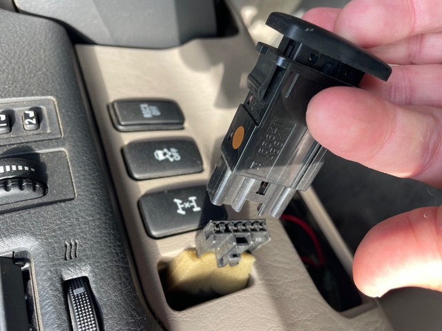

The OEM Inverter isn't working. When I press dash button, the button no longer lights up and there is no power to the hidden two-blade AC outlet in the center console.
I've checked both of the fuses labeled Inverter on the in-cabin fuse block and and under-hood fuse block. They are both good.
I know it has worked in the past, I used it to power a laptop last year.
Any ideas about what to test next before the I tear the cargo panels out to get at the inverter itself?

Turns out the switch was not connected in back. It had spontaneously separated !?!
I went to put the interior fuse panel back on and reached up to feel the back of the switch with the thought that I'd replace it and I realized it wasn't connected. Weird.
