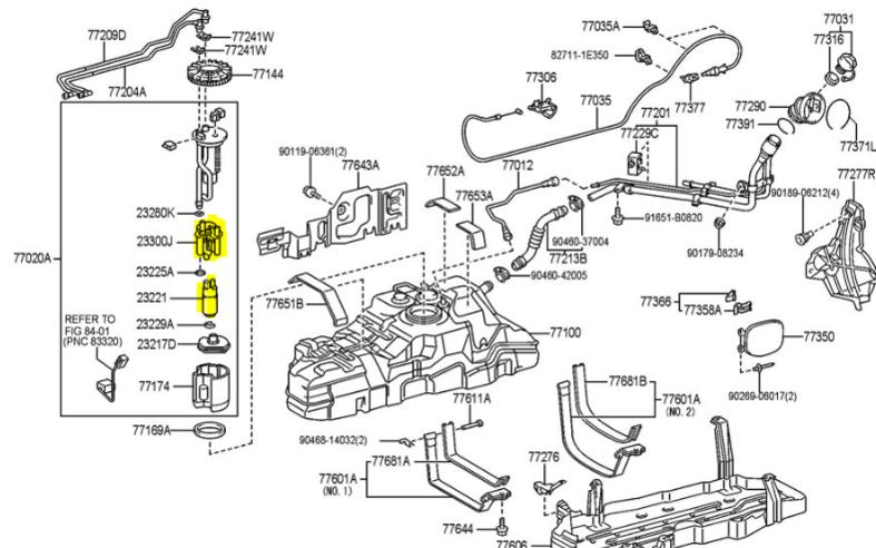

also, i thought it may be the fuel filter. i was thinking maybe it's clogged and is not allowing fuel to get thru very well. so i did some reading and i don't think you can change the fuel filters on a 4th gen 4runner. i remember reading that it is built IN the gas tank so service is near impossible... and actually it is built not to be serviced...? can anyone confirm?

Went up and found where it was ....mine is an 04 V8. This gives you a pretty good ideal where its located.
