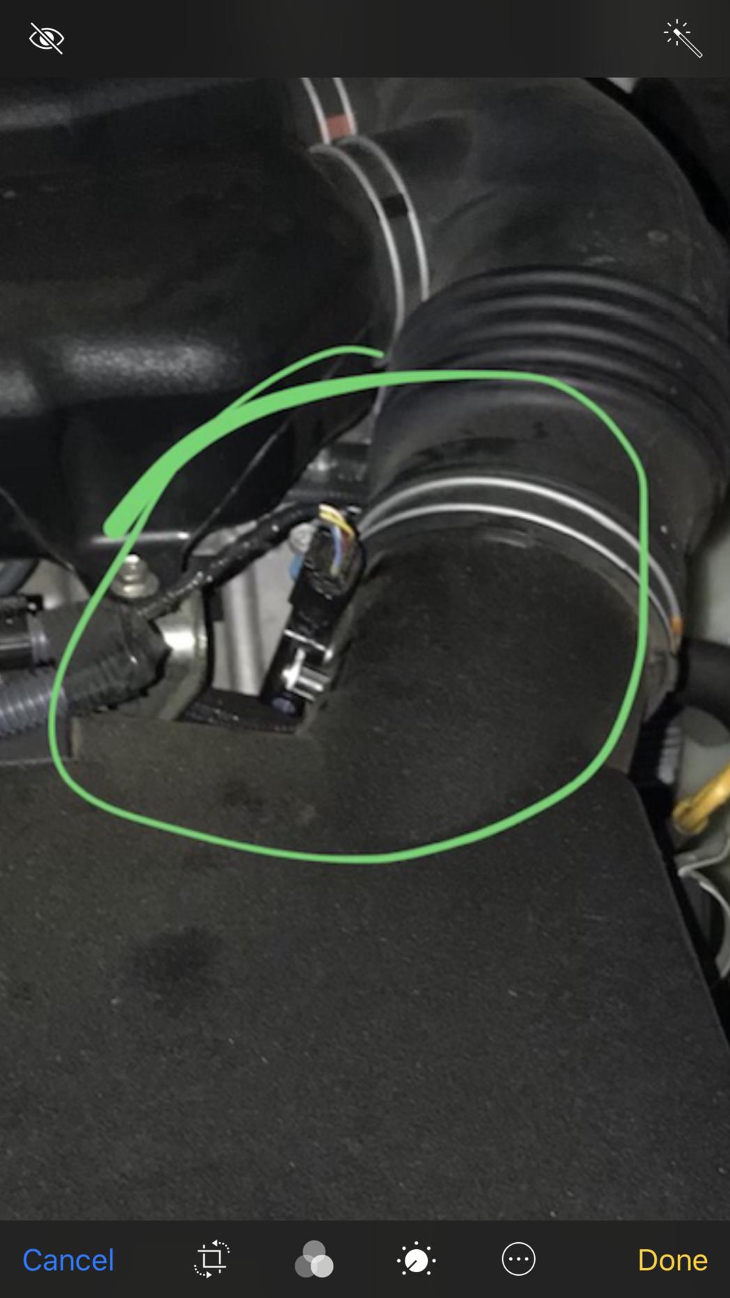

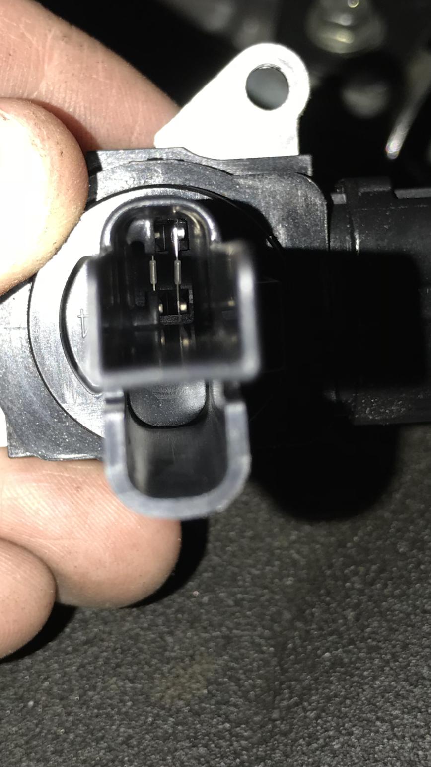

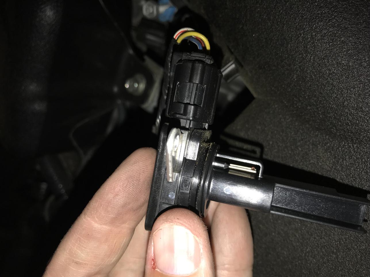

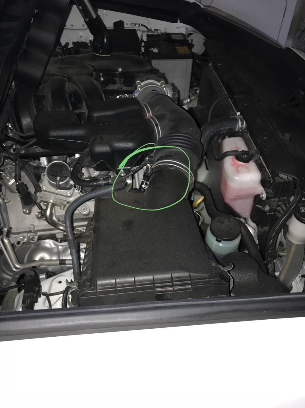

Ok, so I don’t have any mods (that I know of...I bought it used). So I tried to take a look at the MAF sensor. I found a part that is referenced as the MAF meter, and it looked OK to me. I’m gonna try to post some pictures.
I can’t imagine it needs spark plugs, and I messing with fuel filter/pump is above my pay grade!
When I started it today it stalled out. Then I started it again and it almost stalled, then the RPMs shot up, almost stalled then RPMs shot up, and kept up that pattern, getting a little more stable each time.
Guess I’ll let the mechanic take a look at it!
