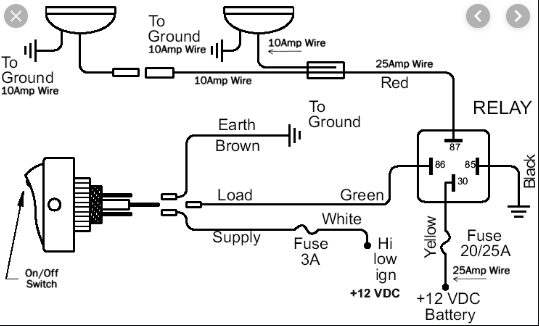

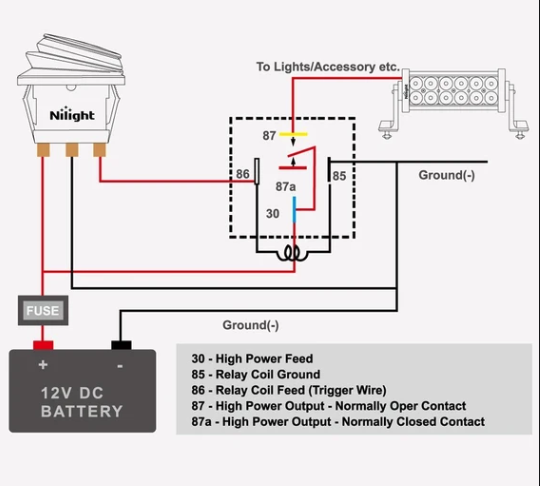

I am in the processes of some rock light wiring and plan to make my own harness. I have a question though and I have found conflicting information.
Does the power for the switch need to be fused separately from the power for the lights? I want the ability to opperate the lights with the truck off so I plan to draw power for the switch directly from the battery.
The top attached diagram show a 3 amp fuse for the switch and a 20 amp fuse for the lights. I know the lights will not need that large of a fuse.
The bottom picture and the harness I currently have for my LED bar only has 1 fuse.

I would fuse the switch/relay circuit separate with a low value fuse as it is a separate circuit that could have a relay coil defect such as shorted internally. Just run both circuits off a constant hot that has the capacity for your amp draw and you should be fine. Is your switch lighted? When i got my 2000, there were two aux lighting circuits powered direct from the battery and the led's on the switches themselves ran 24/7. I rewired them to an accessory hot so they wouldn't run all the time. Which I know is opposite what you are trying to do here.
The lower circuit only has one fuse, because the fuse is upstream from both the switch and the load. One fuse covers both circuits.
The upper has a separate fuse, which is sort of belt and suspenders. If the tap is on a vehicle circuit that is fused, it is optional. I don't fuse switches which are tapped to fused circuits, but in theory, the low value fuse provides a more precise level of protection. If it's pre-wired into a harness, use it.
