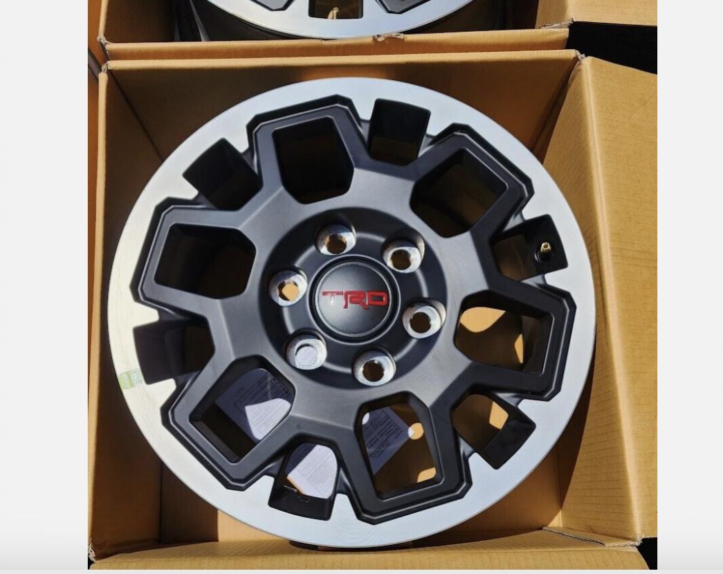

I really like the new rims on the 2025 4Runner Off Road Premium and Tacomas and want to put them on my 2015 4Runner Trail Premium. I was told there is some sort of adapter you have to put on to make the tire pressure sensor work?

TPMS sensors are part of the valve assembly not the wheel itself. New wheels don't usually come with valve assemblies so you you will need to either buy new ones or use the ones from your existing wheels.
If your existing ones are 10 years old it is likely time for new ones. The TPMS sensors have batteries built into them and they don't last forever. So simply buy TPMS sensors for your 2015 and install them in these wheels - should be good to go.
I thought there was an issue using the new Sequoia/ Tacoma/ 4runner 6 lug wheels on 5th gen 4runners too, can't recall what I read though.
