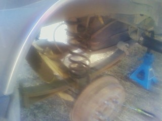

i did the zuk mod and love it. but dont do it the traditional way you see, i got a front set of jeep coils springs out of a late 90's cherrekee and they slide over your bump stops so you dont have to cut them. that isnt very safe. the only way mine will ever come out is if my leaf pack breaks or i cut the spring. i cut 2 inches off before i put them in and i got about an inch over stock height. they act great as an over load spring and the ride is pretty good over all. 0912091046.jpg
sorry about the horrible picture. that was taken like 2 years ago on a crappy phone. o and its still holding up great even though it was so long ago :boink:
