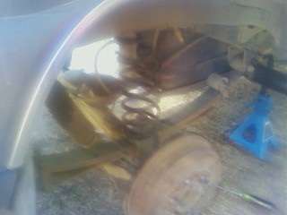

heres what mine looks like with jeep front coils cut down to 11 inches i think.

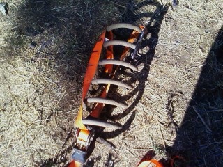

and thats how i put them in. i wore a football helmet and im glad i did because one strap broke and shot out at me. it bent the face mask!!!!!! haha o well im all good now

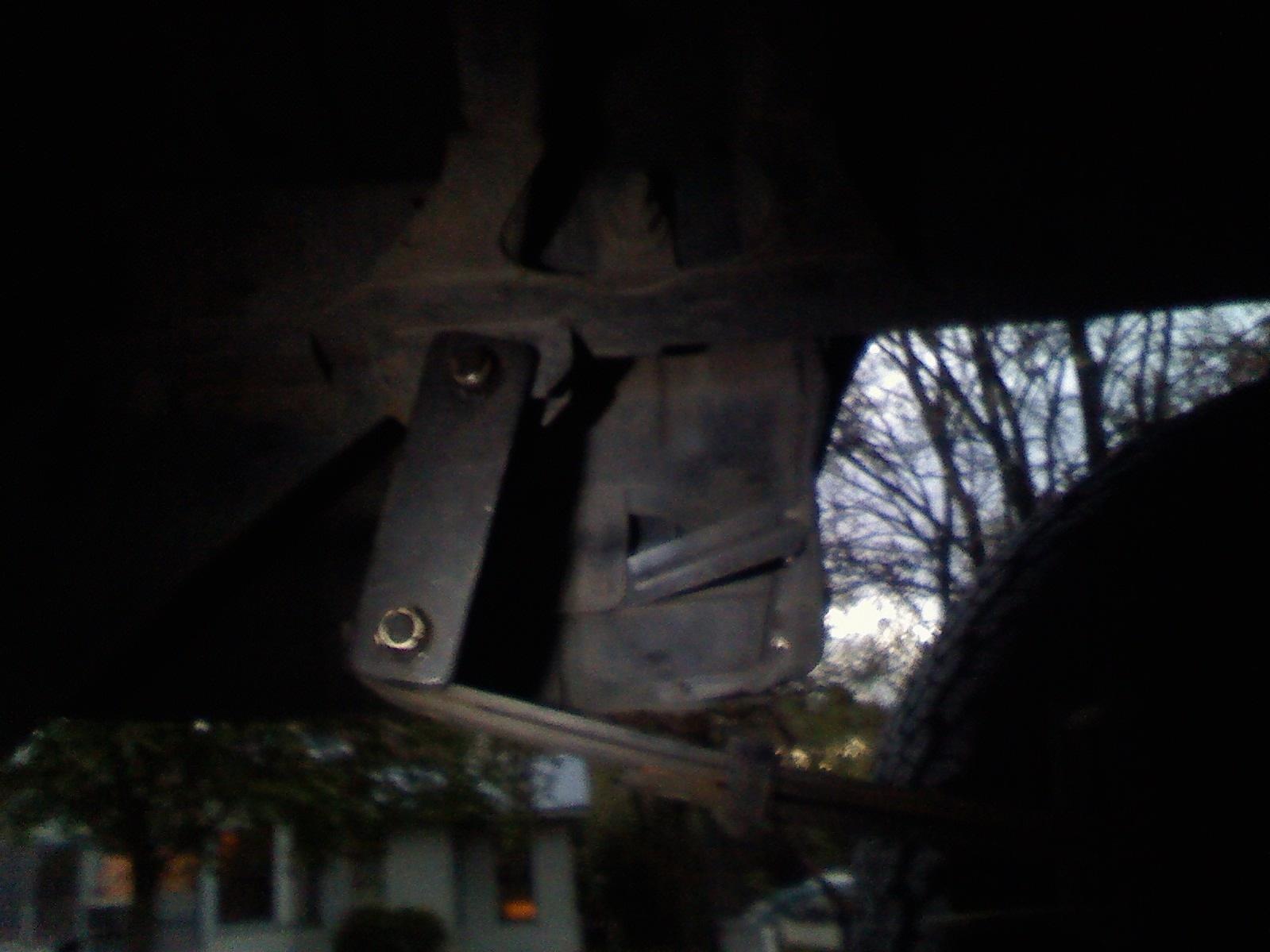

like this... best picture i could do at the moment
