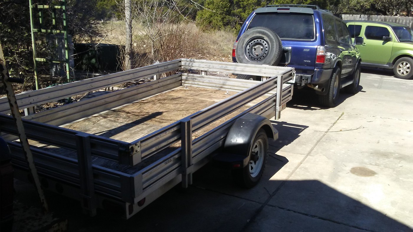

I just bought a light duty trailer. Aluminum construction, 5'4"x10' cargo area. One ton capacity. Do I need to add a trans cooler?
