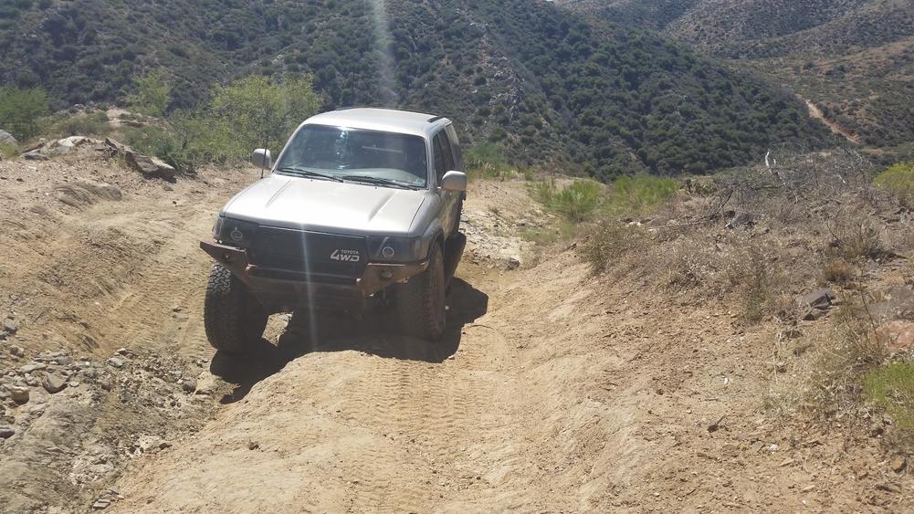

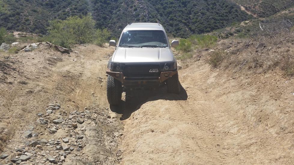

I run his bumper, 33's, 1.5" body lift and tear through any trail a SAS rig can.

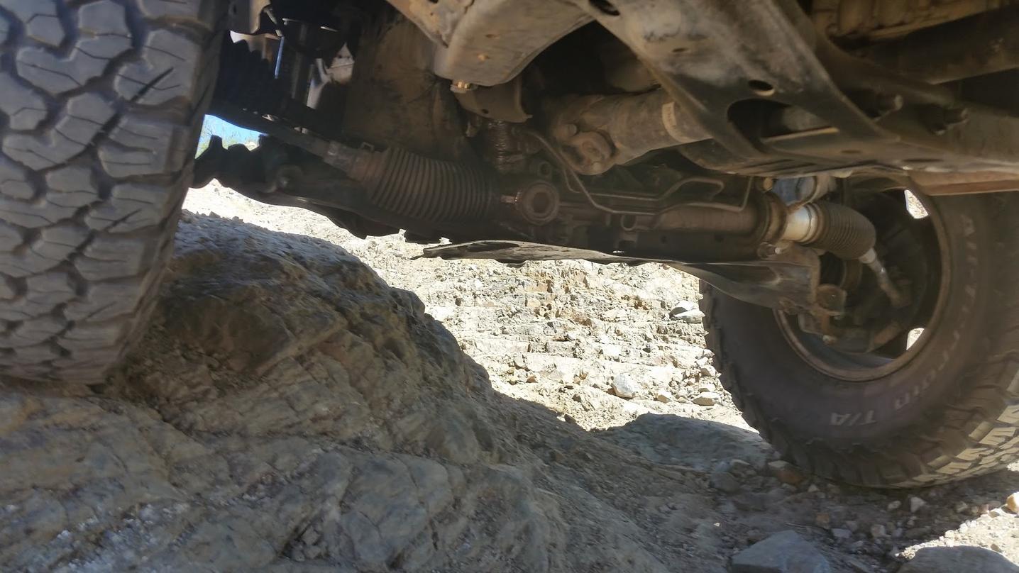

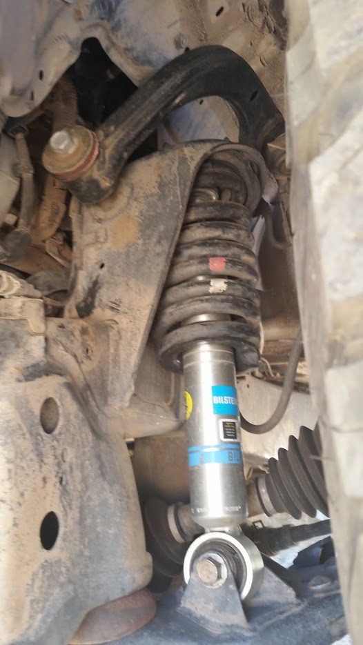

Id have to disagree, the body lift will allow you to move your bumpers up, and sliders, and allow for more up travel, sure it moves some of the weight up, but not as much as suspension lift or adding bigger tires, that being said I think a tapered body lift like I have is a good solution since the up travel in the back is limited by the vertical sidewall of the inner fender if you have wider tires. I also trimmed up front and at the same time because of the body lift I gained about 2.5" of more room to stuff my 35s into, allowing me to shorten my bump stops up front. I will say that for a week or so I was running a full 3" body lift and because the back end has such little weight on the frame it did raise the center of gravity in the rear significantly. After that I tapered all of my lift pucks from 0" in the back to 3" in the front, and it works great and is much more stable in off camber situations. the other reason to body lift only the front is because you cant lift it as much as the back, that being said the front end has more clearance anyways because its ifs, and the back has less clearance because the gas tank and lower control arms, so it makes sense to run more lift in the back than the front. the front end of the body also weighs less and there is much more weight on the front of the frame than the rear so the center of gravity is raised much less than compared to the rear.
I see where you are coming from, ideally you would be able to lift the front and back the same amount and have more balanced up and down travel at the same time, but it doesnt work that way unfortunately.
pics for stuffage. also notice my uca would be hitting the inner fender at the point...

May I ask, do you have a 1.5" gap between your front bumper and the body?
Is it no biggie to you? Care to share pictures?
Yes I do. I painted under so its not as bad. It dont bother me till people mention it but only forum folks see it. Never once in person has someone mentioned the gap.
