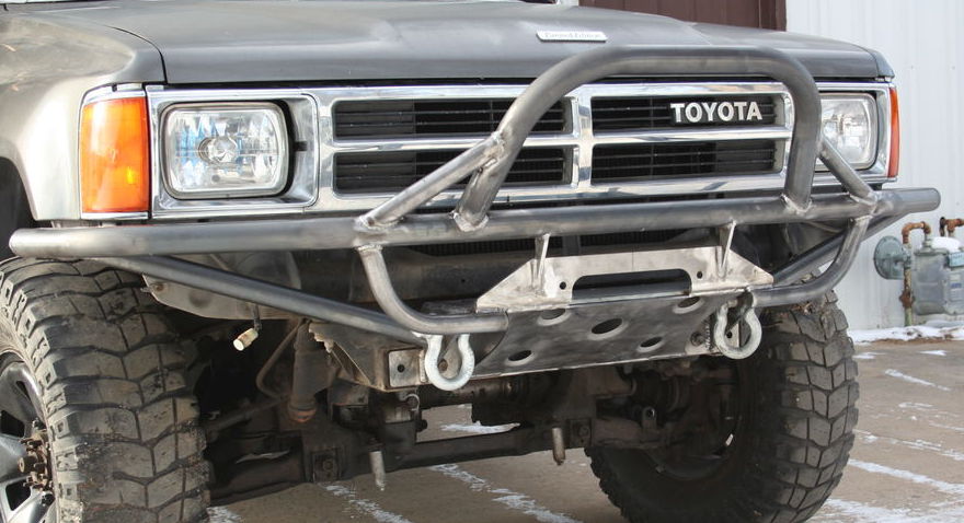

How about some pics so people can check them out and give you their opinion?
They are very similar bumpers in design, which is why I was hoping to get the opinions of people who have actually used one or the other. Nevertheless, any help is better than none and I am open to all of it. Here you go:
Trail-Gear front bumper:
Trail-gear front bumper installed:
Marlin Crawler front bumper installed:
The 2 TG bumpers are slightly different, and the 1st TG one looks like the best design of all 3.
On the 2 TG's I like the beefier trusses from the hoop to the main horizontal bar, compared to the MC.
If they had a vertical plate from the winch mount to the main bar they'd be even stronger.
Probably not the answer you were looking for , just my .02
The TG bumpers are model specific, and I believe the picture of it shown unmounted is the actual model for my 4Runner. As for the MC bumper, it too has a receiver, but it is hard to see in the picture.

I like this one , Addicted Offroad
Pirate4x4.Com Bulletin Board - View Single Post - Addicted Offroad's new Toyota winch bumper
The first TG has the double bar across the front, which is better than the second TG. The TG winch mount areas also have the plate that your fairlead is attached to, whereas the MC looks like just tabs. Of the three options, I would go with the first TG. Addicted Offroad also makes very good quality bumpers, but I think it will run you more. Make sure that whatever you get is made of good DOM material and not some cheap tubing junk. On the winches, a good quality winch for the price is the Smittybilt XRC8. Go ahead and spend a few extra bucks and get it with the synthetic rope.

This first TG bumper looks like it has some side bracing? Does this bolt to the frame?
I'm sure I can see a side bracing on the second TG, the Marlin or the Addicted bumpers. Coming from the 4th Gen world, side bracing was all too important. Is it sufficient on the 1st Gen, to only bolt to the 6 bolt points on the front even for side pulls.
I would think that all the force of the pull gets transfered to the front bolts unevenly on a side pull. But with frame braces on the side the load is also transfer to the side of the frame.
So the better bumper is the one with the side braces. I have no experience with either one it just makes sense to me in my mind... so if someone does have this experience on a bumper/winch mount with out side braces and winches regularly, maybe you can confirm or deny.

CAN-03runner: The side bracing is good, not available on 1st gens without some custom work. The bumpers of 1st gens mount with 4 bolts to the front. The 2ng gens have 4 on the side, but still have the holes for the 4 front also. Is also suggested to reinforce the front 4 bolt because they are known to pull out under load. Addicted offroad makes a nice plate to go over them to make them stronger and add 2 more bolt holes. Hope that helps.

I'm still warry of no side bracing. Maybe it's just me still being a 4th Gen guy and prudish...:nerd:
