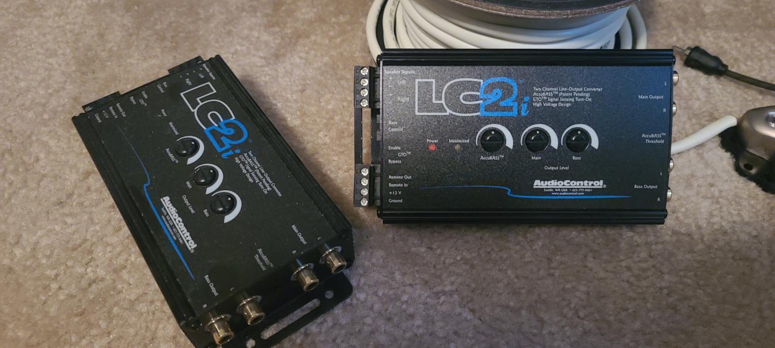

I've been using the AudioControl LC2i for years. They have a ton of great stuff for audiophiles.
