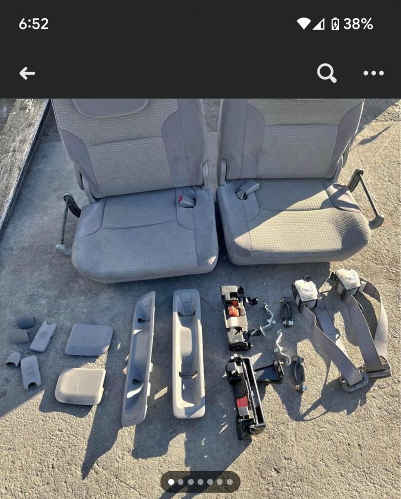

I am looking to buy 3rd row seats including with the hardness, is it possible for the seats along with the hardness to fit on a non 3rd row.
You can't add a factory 3rd row to a non 3rd row 4runner. The rear floor section is different.. there are recesses in the floor of a 3rd row to lock the seats to the floor. The seat anchor rail had to be below the floor so when the seat locks it will be level.
