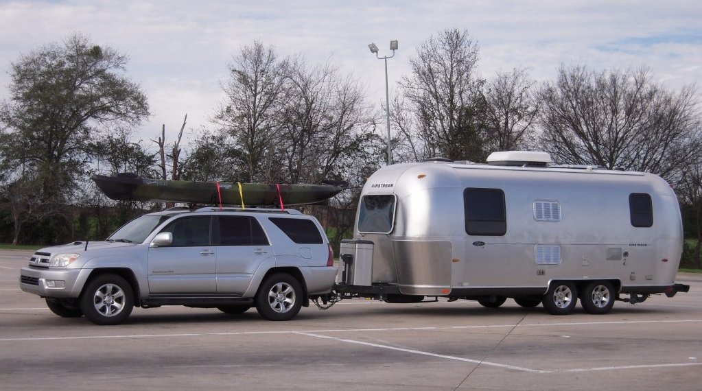

I have a 2004 SE V8, 4WD, XREAS. I pull a 23' Airstream, 6500 lbs. loaded. I have been to Florida, Texas Oregon, Minnesota and just outside of DC. I have never had a problem with towing. I don't use airbags, which do not increase your towing capacity.
If you have your WDH set up properly you don't need anything else. My hitch is an Equalizer and my rig is level when the Airstream is hooked up and loaded. I followed the Airstream forum for several years and the biggest mistakes people make are not having the WDH dialed in correctly and speeding.
If you are using a WDH and your rig is not level I think you should contact the manufacturer to find out what is wrong. A well set up WDH moves weight from the rear axle to the front axle and back onto the trailer. Properly done, it's all level and stable.

Sorry, I misunderstood your post. I too am happy with the XREAS and hope they last the life of the car. I've never even considered airbags to level the car since the WDH does that for me and when I'm not towing the T4R is level. I have had great towing performance with my '04. I hope you find a good solution for the replacement. :D

I also tow a 17' bass boat, weight is about 2300 lbs. I don't recall the tongue weight, maybe about 200 lbs. The Airstream tongue is 730 lbs. which the WDH will shift to the front axle and trailer. The XREAS do a good job of leveling when I tow the boat so I just use a regular hitch for that. If they every go bad, if I still have the Airstream, I'll probably have them repaired/replaced. If not, well, I'll have to give it a think. :) Maybe by then I can move up to the turbo V6 Sequoia.
