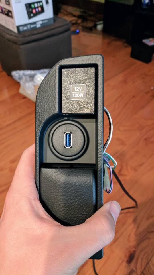

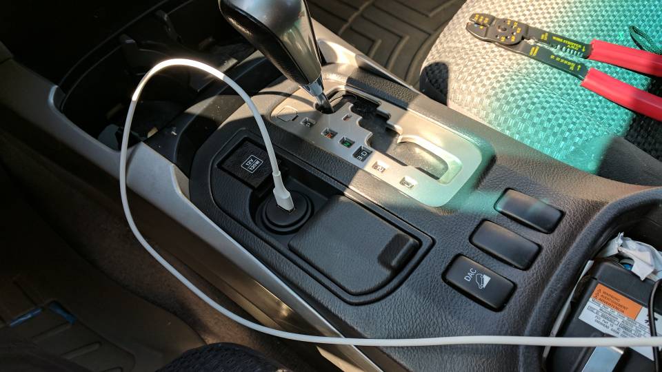

Update. Installed the usb port into the lighter port and was surprisingly easier than I thought. Only took 10 minutes. I'll be doing everything else tomorrow.
Sent from my Pixel XL using Tapatalk
Got it done with minimal issues. The temperature was to blame for most of the issues. Sweaty hands don't hold on to things too great.

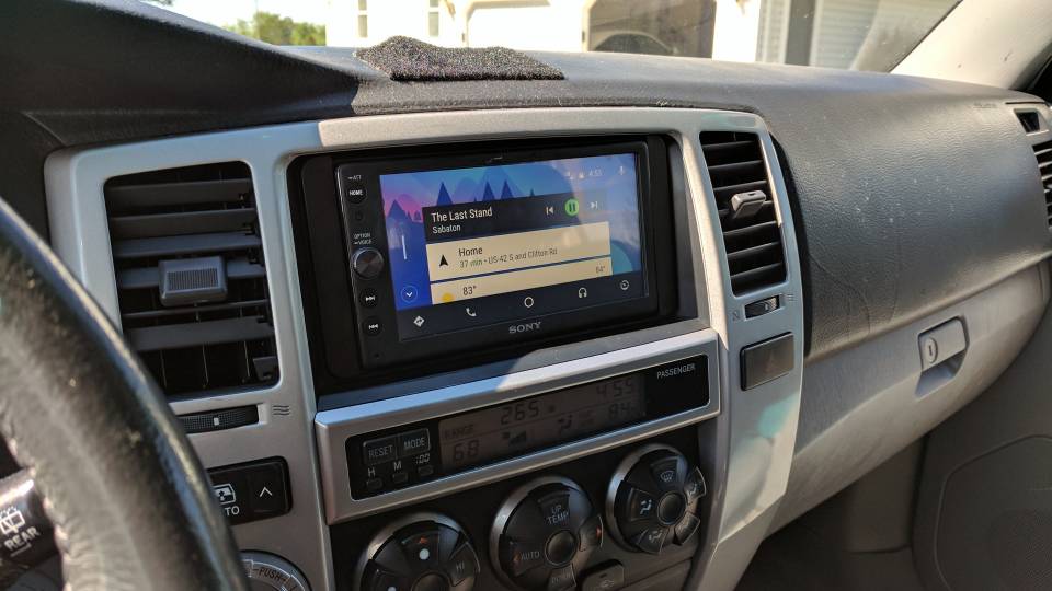

What dash kit did you use for your install? I have that same radio and the kit that came from Crutchfields interferes with the volume knob.
I have the one crutchfield supplied. Something I noticed was the holes I needed to use were extremely hard with the screws provided since they weren't very deep. You may have put the kit in the incorrect mounting holes. I almost did that myself.
